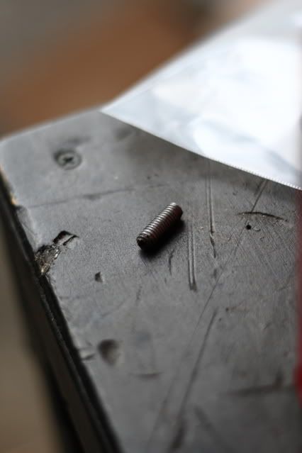

So as is with most things touareg related the plot thickens. After another inspection the leak is still there , found some time today to give the bolts another turn or two. Worked my way around the pan all peachy, got to the front left bolt and wasn't getting results until snap broken bolt , mind you I was using a 1/4" driver so I'm blaming it on a fractured or damaged bolt. It seems the gasket must be softened from external oil contact??

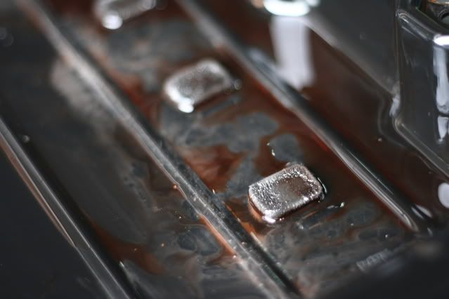

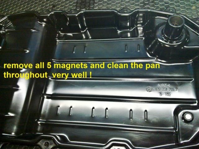

After looking at the discolorartion of the fluid and the amount of metal particles on the magnets and pan i highly recomend a fluid change for high k'ed trannies.
Not to mention how effortlessly it shifts now, so smooth it feels awesome.
metal here metal there
clean

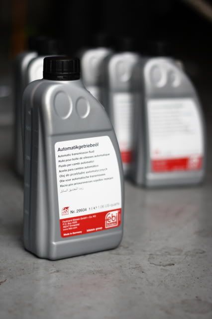

oem febi
Even the snapped bolt co operated

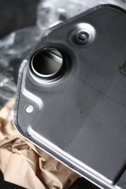

New filter and o-ring

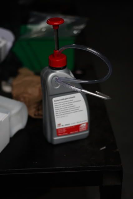

Heres the bit that scares off everybody .To refill you need to pump the fluid through the fillhole in the pan,the larger raised hole. Firstly you add around 3 litres of fluid until it overflows,start the motor , shift through the gears and with it running pump a further 3 odd litres in , or until it overflows again, the fluid needs to reach 30degrees which only takes a few seconds. Reseal the fill hole and your good to go.All up i used about 5.5 litres, which seems a little low to the stats i have read ,but trust me theres nothing more going in there.I found you need to have the cars level to fill correctly so its an intersting 15 odd minutes of pumping under a running car, lucky the beast is so high off the ground.
Its essential to have the hook on the end of the fill hose for the fill hole insurtion.

I can send you up the pump if you do want to tackle it yourself, it really is pretty simple. On a side note you do need a good sized Allan head socket to loosen the fill hole, mine needed a breaker bar as persuasion it was super tight.
Here is the pump I used and the curved end suits this application down to a tee.

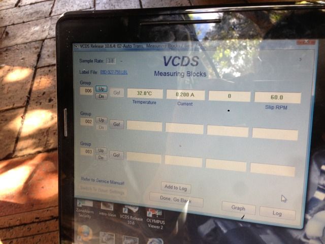

Did a top up today. Finally did it the rite way with vagcom. You can see the temp number , mine was at group 06.
It's amazing how much difference 8 degrees made.

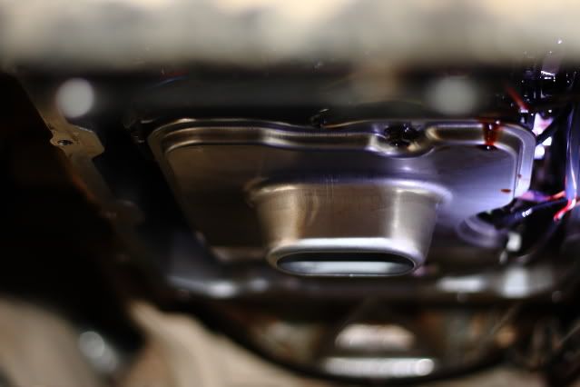

Had a litre of fluid spare so started thinking about doing a top up. With the weather so hot it was proving hard to get the temp low enough. Then I noticed something while looking around club touareg. I noticed on nikoloz post how large the fill tube was on his pan.
The a prefix pan
And my pan.
notice the difference in tube length. So I started hatching a plan of how to fill it another way. I found a write up mentioning a fill hole on the left hand side of the transmission. But I could get near it from the exhaust in the way. Then I remembered almstsobur post about his t3 fill/change.

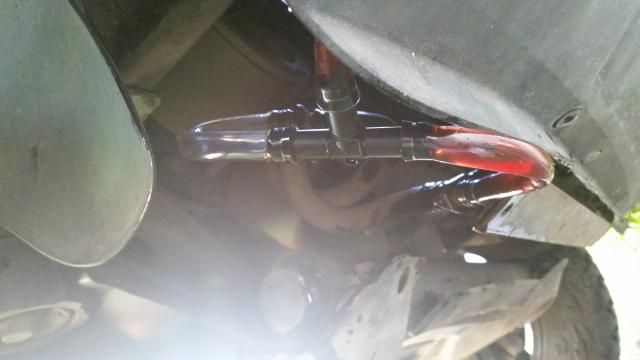

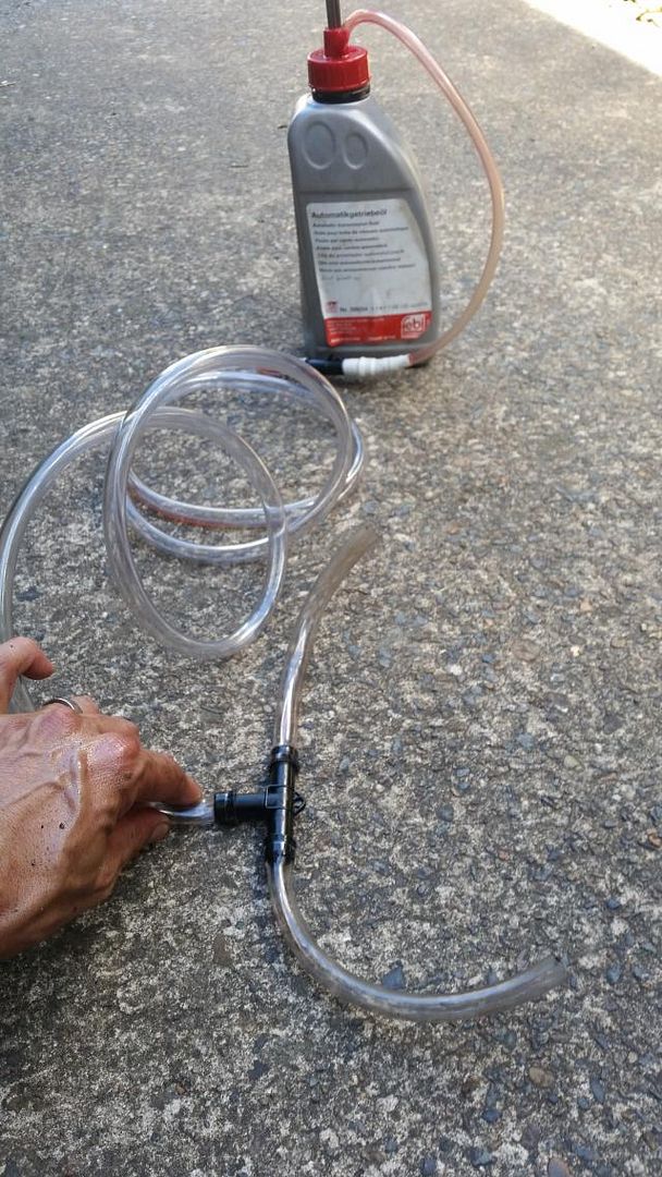

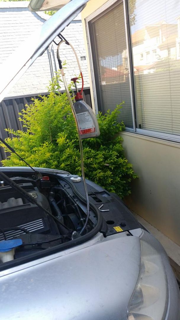

So I followed his lead. Except I didn't want to drop any of my fluid so I tackled it with a tee intersection.
Worked really well and in no time had another litre of fluid in the transmission.
Tee piece and 2 short lengths to join the factory hoses together.
gravity fed. I didn't run the pump at all.
