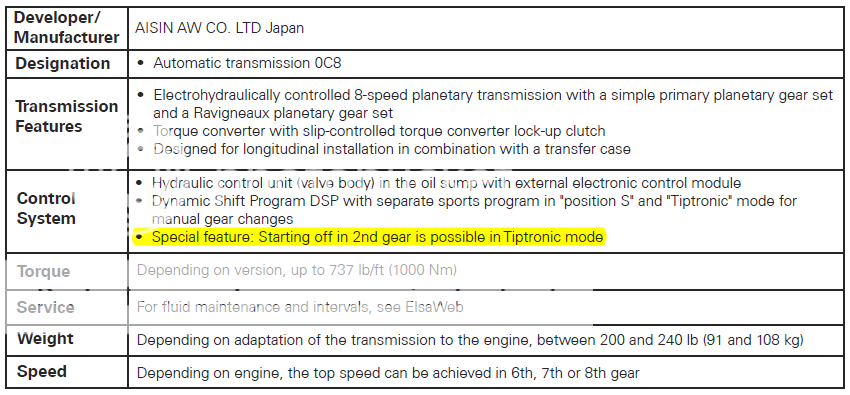

The 2011 Touareg SSP 890103 shows that the transmission can be started in 2nd gear when in Tiptronic mode on page 32:
It does not work on my 2011 TDI. Anyone try this and have it work?
It says it can be started off in second gear, meaning you can put the transmission in tiptronic and place it in 2nd gear to drive off from a stand still.
No modern automatic transmission should ever allow you to start an engine with it in gear. That's a safety features to prevent inadvertent lurching of the car in a forward or reverse direction.
Correct me if I'm wrong....
That is what the SSP said and what I was asking about.

So, have you tried it?
Its also to have a smoother pull away in sand where you dont want to spin wheels with an aggressive first gear start and dig yourself in.
My '12 also does not allow it to start off in 2nd in tiptronic mode. I was hoping it would as in very slow start and stop traffic and in deep snow/very slippery conditions it is beneficial.
I still have one theory to test…. If it is in off road mode, maybe then it is permissible.

this may be a rookie comment but i also have a LandCruiser that has the option to start from a standing stop in second gear - it works really well in deep snow or super slick conditions / ice. I just don't want my touareg to get dust, salt, or winter rash on it so I leave it in the garage when the foul weather shows up and drive the toyota.
it would be a good feature to have - not sure it's active on the 2013 tdi

Look back at the info table in the very first post in this thread and you'll see it suggests referring to Elsaweb for fluid and change recommendations [shame it didn't list what those were though!].
This seems to suggest that the box is not sealed for life. Ask you dealer anyway but it would be great if someone can access Elsaweb to find out what it recommends.
