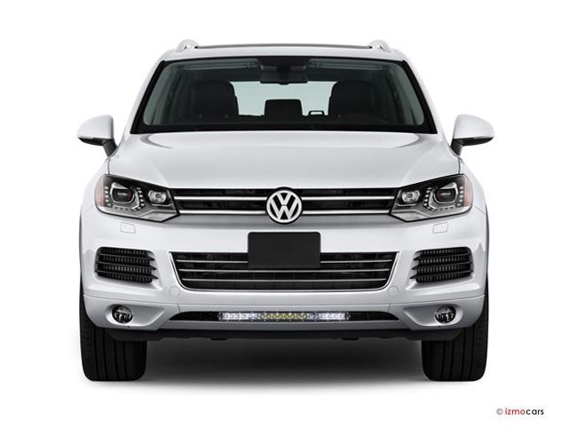

I'm stopping by a local shop tomorrow to check out and possibly purchase a 23" slim LED light bar. I am hoping that I'll be able to mount it in the lower grill on my t3 bumper.
I whipped up a quick photoshop of what I'm thinking:
Here is the link to the bar:
23" 100W CREE 20PC SLIM LED LIGHT BAR
#45 ·
I'm stopping by a local shop tomorrow to check out and possibly purchase a 23" slim LED light bar. I am hoping that I'll be able to mount it in the lower grill on my t3 bumper. I whipped up a quick photoshop of what I'm thinking: Here is the link to the bar: 23" 100W CREE 20PC SLIM LED LIGHT BAR
All the best, hope it fits in well and doesn't impact eng temp much, at all
