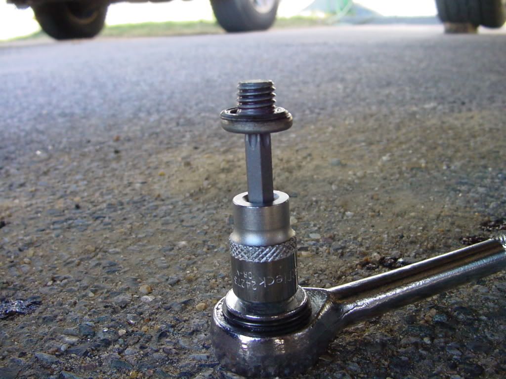

Did the transmission service this weekend. Here's how I did it. I warmed it up before starting. I used ramps in the front to get the elevation I needed underneath so I could work. My driveway is on a slight downward slope so when the front wheels were on the ramps it was level. I checked the vehicle for level by putting a four foot level under the vehicle. First step remove the two shrouds under the car. Next pull the drain plug on the transmission using a T40 Torx bit.

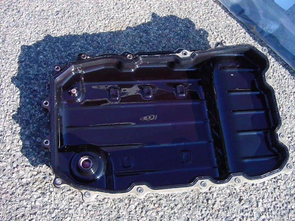

My fluid was somewhat cloudy. Took about 5 minutes to drain. Next I loosened the fill plug using a 5/8 Hex bit, then all the bolts around the transmission pan using a 10mm socket. There are two towards the front that required using an open end 10mm wrench because you can't get a socket in there. Pull the pan down.

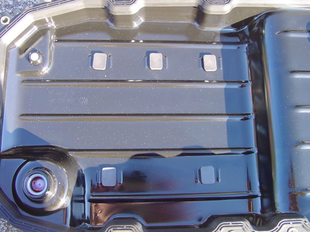

Clean the pan and magnets. I used paper towels, removing each magnet for thorough cleaning.

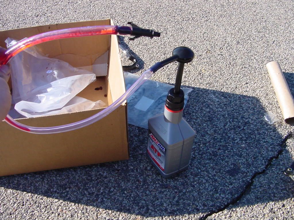

Now put the new gasket on the pan, and re-install pan. Reinstall drain plug. Remove fill plug. I used a simple hand pump that screwed right on top of the Amsoil quart bottles, I got it at Napa.
I did have to modify it a bit to make the 90 degree bend with the tube. The tube itself wouldn't retain that shape so I took an 8" piece of wire and put it inside the tube bending it around the end to get my 90 degree bend. I was able to pump in 3 quarts before I had to start the engine. Once the engine was running I pumped in another 3.5 quarts. I used Amsoil ATF-QT. Let it warm up for a few minutes so the excess could drip out while the transmission came up to temp. Put the fill plug back in. Put shrouds back on. Done. Took me about an hour and a half. Using the hand pump wasn't bad at all, it took about 15-20 pumps per quart. The transmission now shifts remarkably smooth, I can hardly feel it shift anymore. Before the change 1-2 was jerky, now it's butter smooth. Also when cold it shifts very smooth as well, no more jerky up-shifting and downshifting. Paid $65 for filter, filter gasket, and pan gasket from rmeuropean.com. Paid $80 for 8 quarts of Amsoil ATF-QT at Napa. Total cost $145.

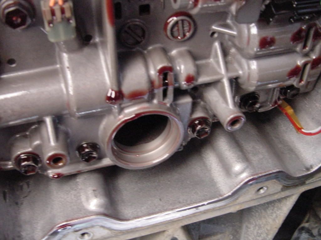

Is this part the transmission filter/strainer people are talking of:
For peoples information #4 is the notorious transmission valve which gives so many people so much woe. I dont like the idea of electrical connections bathed in oil, oil generally being a conductor (Especially mineral) and so many connections looks like a recipie for heartache to me.

Yet the electrical connection to that pump is on the outside of the tank, i just dont like the idea of it, fuel pumps are usually hard wired to the outside of the tank anyways. To me the valve should be mounted on the side of the gearbox, not inside. Its not impossible, just the porting needs thinking out a bit more.
I must admit I was very surprised to see those wires bathed in ATF.

Hey Alex, where did you get that pump?
