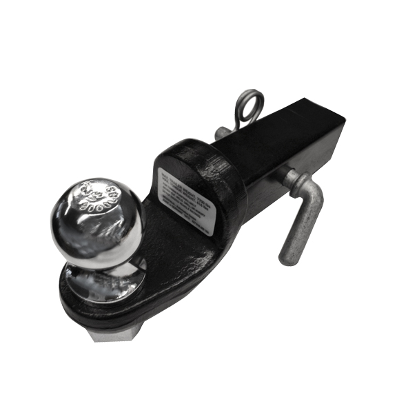

I was surprised to see that the VW tow bar was solid, not tubing like the Reese hitches and other brands that are out there. It did have the 7700lb rating on it. However, my other tow bar fit just fine.
Yep - my Reese bar is hollow & rated to 6000#. My race car is 3000# and the trailer is about 1000#m so I'm ony at 66% of the bar's rating.

The dealer set me up with a tow setup that has a 10 and 1/4 reach from pin to c/l of the ball . the tag shows it should not exceed 6.15,should i just run it thru my band saw and redrill the pin hole to bring it closer to that dimension?.It would seem a better tow setup with the weight closer to the treg and more over the rear rather than leveraging out there at 10+ inches.
Personally I think I would go back to the dealer and ask for the VW hitch (shank or whatever you guys call it over there, the part that holds the ball and goes into the square hole) rather than use what is obviously not a VW one. All VW ones have the correct reach, and the ball is rated for the correct towing amount.
Can you be sure that the one they have given you is rated for the full 7700lbs (3500kgs for us down here)?
As for cutting, well it is your choice, but if it fails, or is out by a bit and causes something else to go wrong, then it won't be just you who suffers, the vehicle traveling behind you can also be involved.
I do agree that the closer the hitch point is to the back axle then the more stable the tow would be (but that is only my opinion) and is one of the advantages of the Treg over many other vehicles.

Personally I find VWs spec for length of shank dangerously close for comfort. Trailer can be too close to rear of vehicle and could make for dangerous angles when manouvering.
I always ignored this spec as there is no standard shank out there that meets this spec...for me I believe it far more important to match tow height to shank height, and the one size fits all VW shank certainly does not allow you to do this.
I found 10k rated forged solid aluminum drawbar and as its not hollow, I cutted it shorter, re-drilled the hole and now mine is 6.5 inches...
