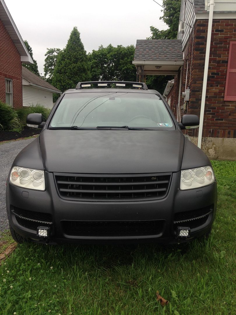

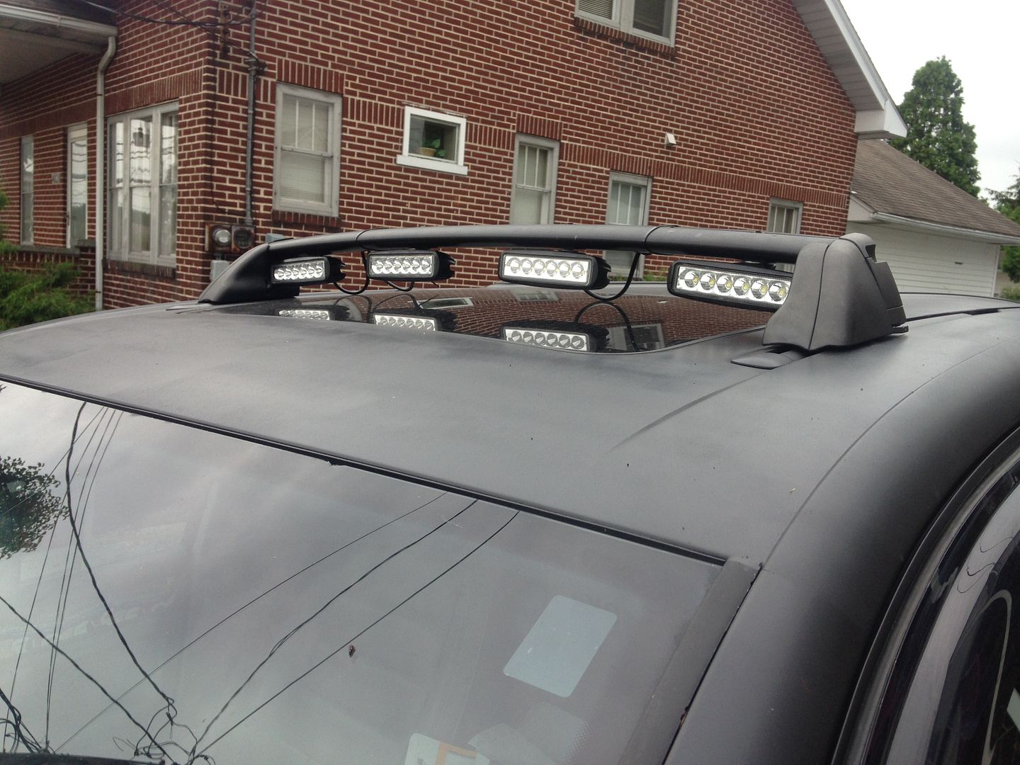

How did you guys go about running the power wire up to your lights or light bar? I'm getting ready to mount a light bar on the cargo rack on the roof of my Treg and I'm trying to figure out how to run the power wire to it.....without making it stick out like a sore thumb. How are you guys running the power wires up to your lights on the roof?
#113 ·
You could route the cable up through the hood along the edge of the windshield. I would think it would blend into pretty well there. From there you'd have a small distance to get from the top of the windshield to the track for the rails.
