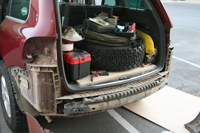

Do you have any information about these holes? I'm thinking of fabricating an external spare carrier and was at first just contemplating one that mounts to the tow hitch. But, if the bolt mounts exist on my 04, perhaps a custom rack could be mounted to them without having to replace the rear hatch?

i dont think theres much space around where the spare wheel goes on the back, especially the lower side. maybe just enough space between the lower side and the moulding to slide a finger in.
Are you referring to the bolts - driver side - under the bumper molding ?
Here is an image of the area on a 2006 T1 (like a 2004). The external hatch would mount to these four bolts.
Reactions: Granola02
Yeah, those are the bolts I was wondering about. Do you think it would be possible to design and fabricate a custom swinging tire mount that could bolt onto those? Obviously you'd have to drill some holes in the bumper to accommodate the bolts, but with a custom tire arm you would not need to replace the rear hatch.
That's exactly what I plan on doing. I got lucky and got my hands on a brand new rear bumper skin for the spare wheel carrier version and I want to fit this and fabricate my own carrier. But it's a long term project, so it won't happen soon. BTW the prices for the two versions of the skin are basically the same.
