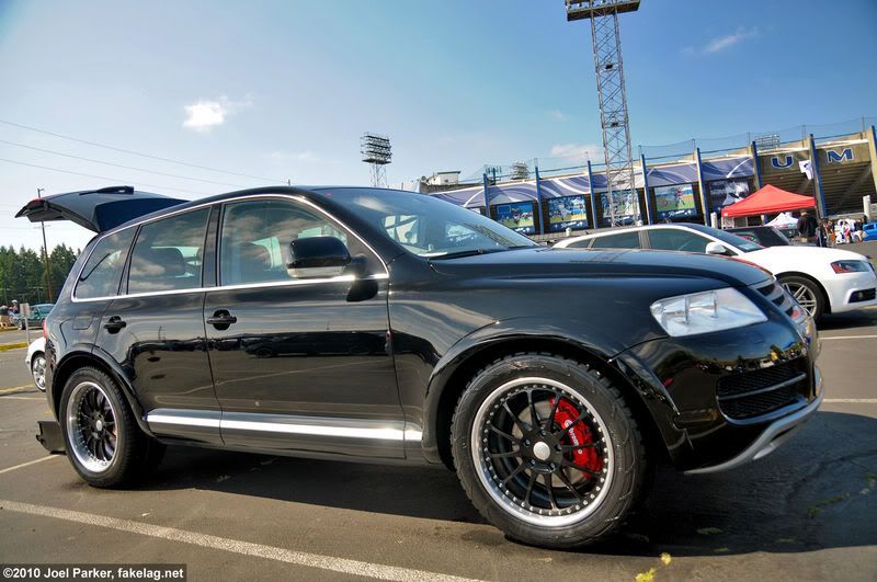

VW recommended 275-40-20 on 20X9 rims. Being a fat rubber type of guy(love the look from the rear when followed), I was thinking of going to a 295-40-20 size. A difference of 2.2%, diameter 728mm vs 744mm respectively, and a speedo error of 70mph vs 71.54. All negligible.
The only catch by moving to the 295mm tire size, is that these 20in mags that I was eyeing, and getting prepared to buy literally today, come only in 9 inch widths. It seems that 285-40-20 would mean a MINIMUM of 9.5 inch width, and the 295-40-20 that I was hoping for would mean a MINIMUM rim width of 10 inches! So that truly limits my search for a good looking 20 inch mag. Back to the drawing board :mad:
Does that all sound right? Do those online calculators specs that I posted up above sound right? In any case, who else here is running "fatter" tires on his/her Touareg?
Yup. Those 295/40/20 in all those pictures are looking tastier all the time! Nice look, and very SUV'ish. Me like.
Something that is now confusing me though. Those mags in your link are OEM VW mags called Ayers Rock; size: 9jX20 ET60; Part# 7L6601149AZ31
From what I have read from the recommendations of various members on here, it has been suggested to never go over 275mm width on a 9X20. 295/40/20, it is recommended to go with at least a 10inch wide mag(from what I have read on here). Now is this rule embedded in stone, or is it one of those made to break slightly? The pictures in that link suggest to break, unless I'm missing something here?

you're right about the 295 needing a 10" wide wheel
but besides that, what is the proper offset for the 10" wide wheel without rubbing on the T2?
