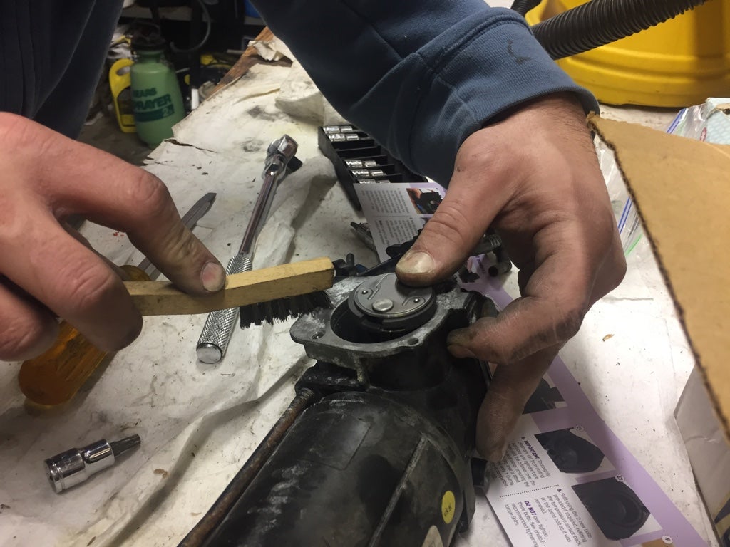

How to repair / refurbish your air suspension compressor for $40
15K views 19 replies 7 participants last post by  noobytoogy
Looking at this site makes me think anyone with an older car on air should consider refurbishing their compressor regardless!
Andy ships:
http://www.bagpipingandy.com/
I bought one of his kits over the summer and finally got around to installing it over New Years. It's a very complete kit, and the install is straightforward.
Before the compressor was getting rattley - not super surprising as this is an 04 with 160k miles. With the new piston ring the compressor is barely audible!
-J
No, I only had to unhook the brown line (spare tire filler) and the black line to the valve block (compressor output). To get the black line out I had to unhook the compressor from the bracket, there wasn't enough clearance.
I cut the clamp off the larger black intake line's rubber union by the wheel well and disconnected it there, it was easier to deal with that line off of the truck.
Because I didn't disconnect the valve block the suspension didn't deflate.
-J
Thanks, this is worthwhile investment

If the compressor is noisy replace the piston ring. Heck, I'd say most T1s at this point would benefit from a replacement piston ring.
Our truck used to take 3 compressor cycles to fill the air tanks (the compressor has a temp sensor and turns off when it gets too hot). Now it does it in one cycle :)

So hats off to bagpipingandy!! Rebuild was super simple! Removal and install super easy. I found this super helpful..
Removal and installation of the compressor unit without solenoid valve. Volkswagen Touareg (from 2003 to 2006, the year of issue)
Only I highly recommend loosening the compressor mount assembly before trying to remove any clips or airlines.
Now my new treg raises and lowers with ease..No more fault codes and the compressor is nearly silent as opposed to before.Also after being in that area if you do not have road gaurds on that side I highly recommend them as to keep everything clean and dry ...Lots of connection and couplings you want to keep safe from the elements
