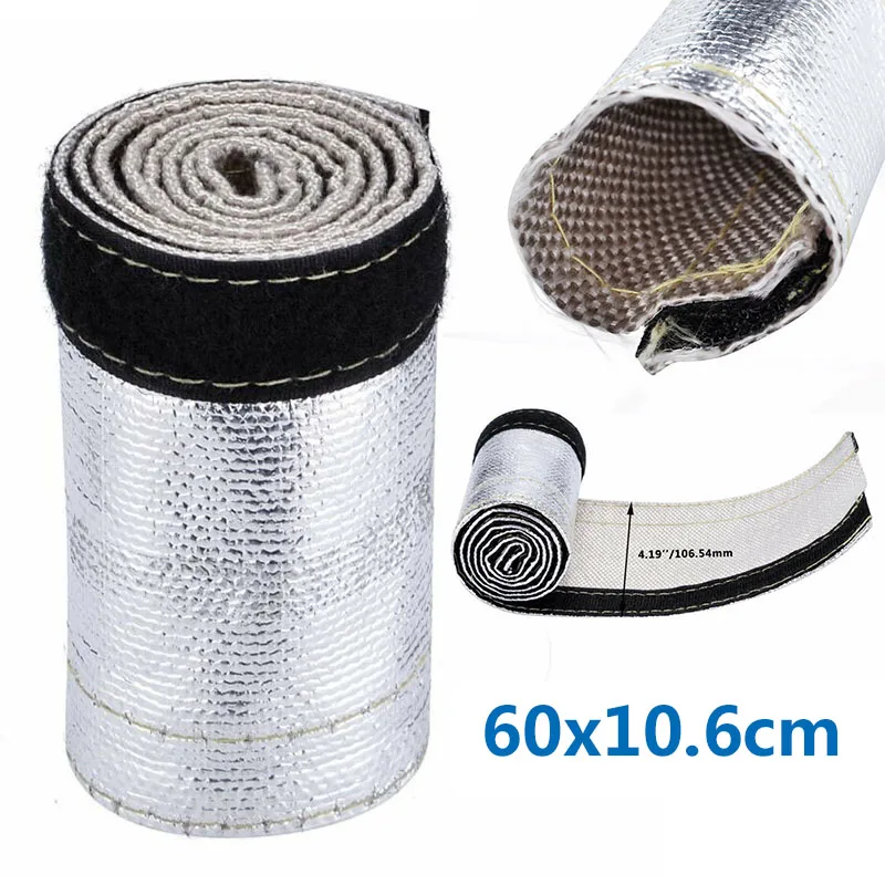

Here is the Porsche part I bought to get both hoses and the pump for lest than 30€. So I have a spare pump and some spare hoses just in case. I didn't want to touch that gunked hose on the passenger side of the engine unless I have a replacement. I'm also getting heat/insulation material from aliexpress to protect the hoses. The pump sites behind the engine by the way.
