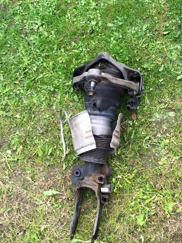

I've just joined this useful forum to make sure I get all the info on fixing my problem on my 2003 v10 Touareg. Today my front left air spring thought it will end its life by going bang on me going over all things such as a speed bump.
i have ordered a new air spring to fix it but in the mean time i thought i have a look to see if there was any tips or hints to help me out. Also once i have installed the the air spring do i need to reset anything due to the new air spring?
thanks for your help in advance.
here is some pictures of the failed unit

What is all the bronze coloured stuff on the strut?
Was there a lot of oil about as it looks like it?
If there was did it come from the strut as maybe the shock part is stuffed also and has been leaking its oil?

The colour on the shock is just a bit of light rust it wet because it is hammering it down today and some deep puddle around where i live.

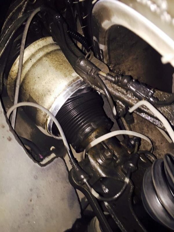

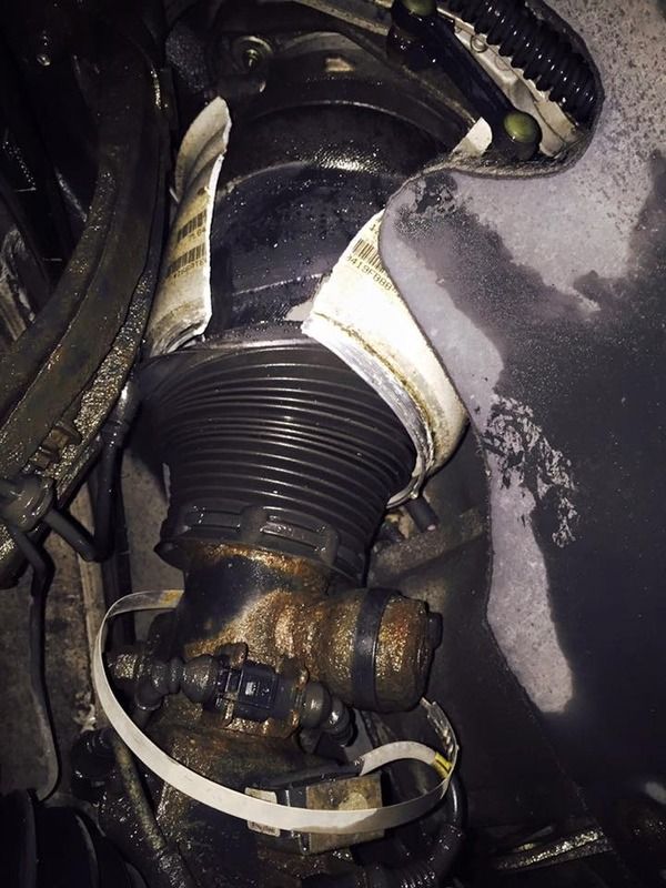

Well got the strut out today, also why I was at it, I did the rear pads and discs(rotors), so while I was doing that I also checked all the other shocks over and they all seamed fine. New air spring should be here by Friday at the cost of ÂŁ250 coming from Germany. VW here in the UK quoted ÂŁ1450+vat(vat=20%) and would take 10 days so I thought I'll give that a miss.
Would be nice to know why they fail in this way, it's almost like the air bag over inflates and burst through the metal.
My front right just popped 1 hour ago and here I am joining the discussion. What happened to me was the metal sleeve that holds the bag together failed first and cracked wide open and then the bag went literary 2 minutes after it. I think that the metal ages and developed cracks that are put under further pressure by the bag and eventually fail.
