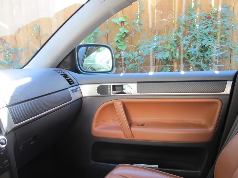

I was so impressed with this 3M Di Noc vinyl material that I had to share. It only cost me $50 and about 4 hours of my time. What do you think?

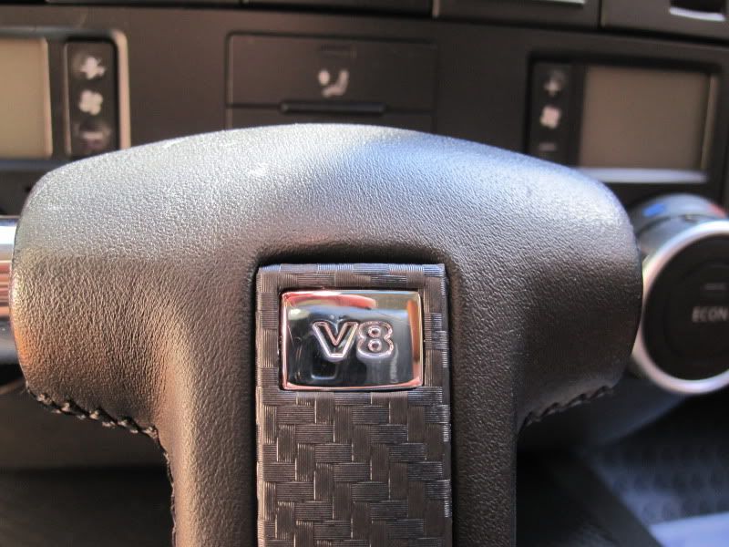

This was the first thing on my list when I got my Touareg back in October... Finally did it last night. Took about 4 hours with my buddy applying the film and me removing/installing all of the trim. It was the first time we used it to wrap interior pieces. We have done a few roofs though...

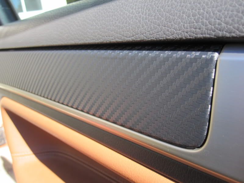

What's the real world feal of this material? Shiny or glossy at all?
You had the wooden material before you applied this? Now that you're done, you feel the carbon looks a lot better? A keeper? I'm afraid it looks too matte and out of place compared to the rest of the materials in the car? What's your say on that?

I removed all pieces. for the dash pieces, pull the silver off then seperate the wood from the backside. There are clips holding the pieces on. The piece in the shifter just pulls out from the top with a credit card or similar tool. The center console pieces are held on with 2 screws under the armrest tray. The doors are where it gets tricky. You have to pull the door panels off, 4 screws per door and then remove 6-7 screws holding the silver trim on. All in all, it took about an hour to rip the interior apart and 4 to put the vinyl on.
Personally, i think it looks infinitely better. It is matte, but the weave catches the light and looks awesome.

It's not necessary to pull all the trim off. The door and dash is so flat that you can leave it on and apply the material. Just use a fresh exacto knife blade so you can trim the material easily without using much pressure. flatten the edges with a credit card after you trim it so you don't cut into your door or dash.
