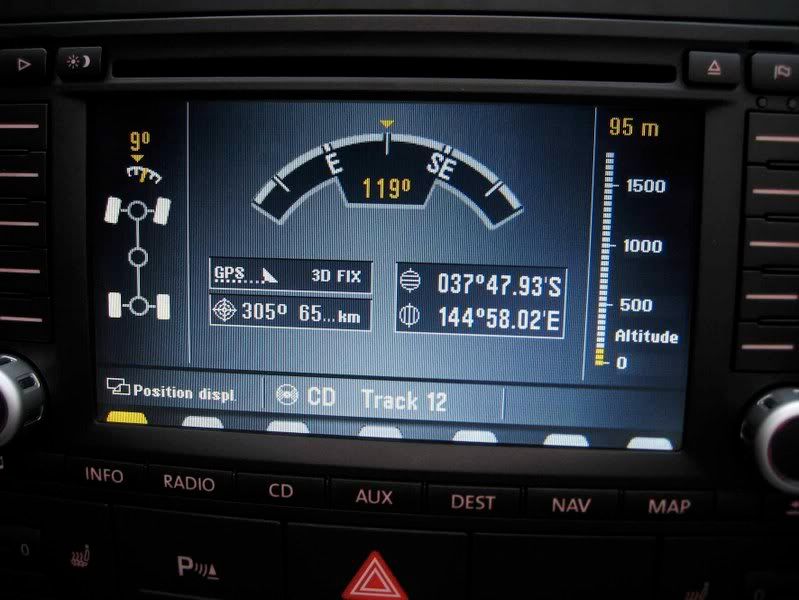

Hey everyone...
I recently sourced a VW DVD Navi unit off ebay, and just got it installed today. I thought i'd upload some pics as how it works.
So far everything works, i'm just waiting on an Australian Navi DVD. It is basically 'plug and play'. All the plugs already in your non-navi Touareg will work. Even the ipod Adapter works still.
I was surprised that the compass etc works well:
If you don't have a colour intrument panel like mine, then the word "Navigation" is added to the menu:
Then if you click on it it comes up with this. You can also scroll through CD tracks when in this position:
Finally just a quick question, where is says "SECOND TUNER" What is the difference between the "SOUND" option and "TMC"? I can't seem to hear any difference
So there you have it, seems you CAN install Navigation easily into a non-navi Touareg. i'm really happy with the unit looks great amongst the already classy Touareg interior!!

This is an option for Europe, I guess.
I don't know, whether you guys can use TMC in the US. As for Germany, you can use the second tuner either to search permanently for a better frequency for the radio station you are listening to and, thus, enhancing the quality of the radio sounds (by automatically changing to the best frequency) or you can use it for TMC (TrafficMessageChannel). Enabling TMC will set the second tuner to any receiveable TMC-Station. So it picks up all Traffic messages (accidents, traffic jams, etc.) and takes these information into calculation for the best navigation route.
However, precondition of course is that a TMC-System is installed in the radio network and I am not to sure about that in the US.
Regarding your mod: I did the same. I installed a DVD-navigation unit in my 04 Touareg and it was plug and play, basically. It only required one change by VAG-Com and that's it. I also change my head-display into the bigger multi-color one. Wasn't a problem either.

Are you SURE that's the DVD Navi? It looks like the CD Nav to me. The clues are the presence of the 'AUX' and the lack of the 'VOICE' button found on the DVD version. Is it a European DVD Nav? If so then that might explain the discrepancy.
*EDIT*
I took a closer look and it appears that the 'ESC' button is not the same as on the US CD Nav so I guess it is a Euro DVD unit. Also, I see you're from Australia which explains the differences.
