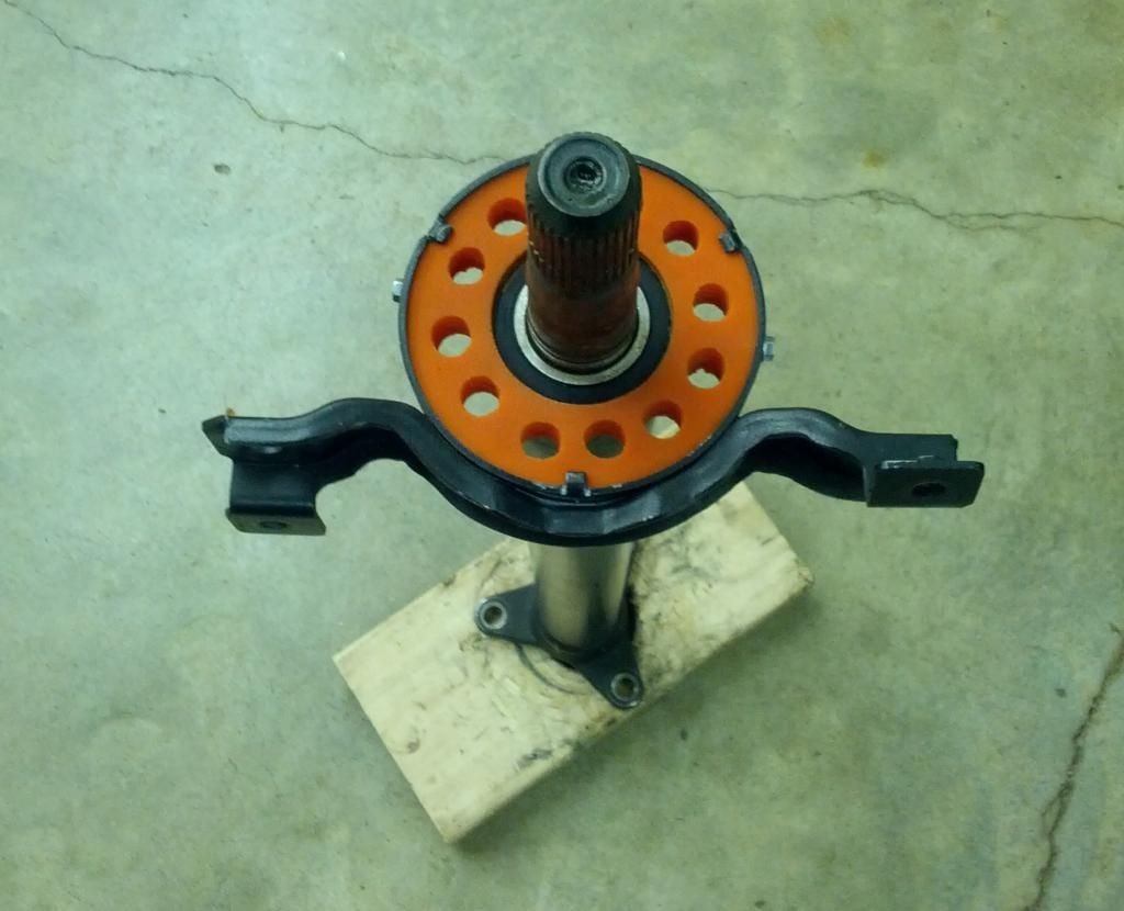

Hello, Im an active member of the cadillac forums and LS1tech forum. For the last year we have been involved in repairing and servicing the cadillac CTS-V driveshafts (made by GKN) and have designed, tested, and manufactured Polyurethane DriveShaft Carrier Bearings for the cadillac CTS-V, CTS, STS, SRX. Pontiac GTO. and various other plaforms. While doing research I came across the VW TOUAREG driveshaft and noticed how similar it is to the CTS-V. We have special tooling and jigs for the CTS-V driveshaft as it is considered non servicable, which just so happen to fit the TOUAREG driveshaft.
My whole point in posting here is to show the units we have made for other platforms and gauge the interest level that TOUAREG owners might have in a permanent fix for the driveshaft carrier bearing which also adds a performance factor. The bearings are High Quality Japanese KOYO units with radial and rmp ratings that exceed OEM specs. Here are a few pictures.
Red Solid 30a. (CTS-V Bracket)
"Drilled" Orange 50a.
"Drilled" Orange 50a on CTS-V shaft.

Thank you Stuart. The thing we have seen on the CTS-V when people attempt the install themselves are issues with separating the two halves of the driveshaft, maintaining correct clocking, and the most common is the center CV boot leaking grease. For our purposes we build a jig table that keeps the driveshaft clocked correctly and aligned, we also created special tooling to correctly seal the CV boot so that grease wont leak. Since construction of the cts-v shaft and touareg shaft are the same, our tools also work on the touareg shaft.
What's the difference between solid red and drilled orange?
Apart from the fact one is red and solid, and the other is orange and drilled . . .
haha well apart from those visual differences.. the two units are different durometers which is a hardness factor.
the red 30a solid unit... has a durometer (hardness) of 30a. Its a pretty soft polyurethane but much more sturdy than the OEM rubber carrier.
The Orange unit has a durometer of 50a and is a pretty firm unit. The relief holes to to provide a little bit of movement under load.
There are scales online that have comparisons to each durometer rating but that is just a general idea, because the thickness of the poly highly affects its ability to withstand pressure. 30a might be compared to the softness of a rubber band, but at a little over 1/2" (17.78mm) that rubber band becomes pretty tough.

So, what is the functional and price difference in the two? In other words, why do you make two different ones?
Yes, one is harder (firmer) than the other but you drill holes thru it which effectively softens it up.
For now just the bearing units separately or with installation. We've been kicking around the idea of creating DIY'er friendly tooling, but that hasn't come to fruition yet. I had ordered a nice quality touareg bearing kit last week to see if our setup will work, and it appears it will. We already have all the systems in place for the current platforms we service and supply. It wouldn't be a big deal to add the touareg into the lineup. Currently when we install our poly units, we utilize the factory steel carrier bracket.

The issue lies here.... We potentially would be willing to offer a Poly unit at no cost, BUT is that person capable of correctly separating the driveshaft, install our unit, and reassemble properly to ensure that the cv joint wont puke grease all over and ruin the joint. Or clock the shaft wrong when reassembling and then be off balance only to blame our carrier on the vibrations? Our units are on many many other platforms with ZERO issues. SO we would be willing to offer a promotional Poly carrier to someone who is 100% sure they can correctly complete the install. Or if they wanted to send their driveshaft in for servicing, we would deduct the poly unit cost from the total standard fee. Thats what we can offer.
