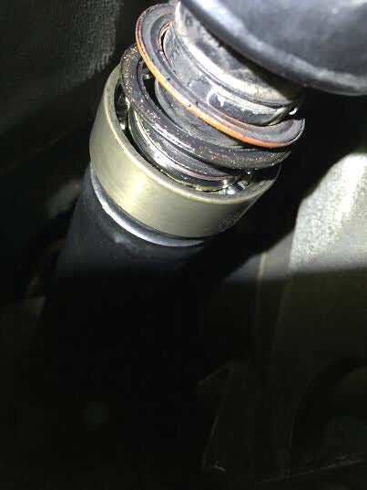

My Drive Shaft Bearing Mount support failed about 4 days ago.... looked at the forum for help and considered a number of options... Thanks to Dragline1570 managed to do a home remedy.
Clarke Rubber - 19mm hose (heavy duty) + 3mm one sided adhesive rubber.
The gap between the mounting bracket and the bearing is about 22mm (radius).
Wasnt too hard, my old man helped me out. Thank God for the fact that the Touareg has a bit of clearance, just a ramp for the rear wheels, and not too had after that.
See pics taken this morning:
