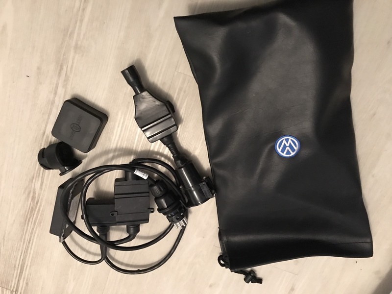

then called up a VW dealer and got quoted $137.00 for a patch cable to go inline between vehicle and trailers. its not actually a genuine item which are $250ish, but a narva one that has been modified with resistors. it still is sold over the counter from Solitaire VW parts at mile end (biggest VW dealer in adelaide). i would rather have something hard wired into the car, but at least this works.
so if anyone in Adelaide needs a patch cable, they had 11 in stock.

The two adapters are very different. The VW one is using large resistors heatsinked to the die cast case. Each resistor simulating the load of a 20watt light bulb. This approach is pretty sure to work.
The Ford approach I would guess is using much smaller resistors thus the different packaging size but this is the point - this adapter will be tuned to the Ford trailer module. I would guess that the Ford trailer model does not need the full 20watt load per circuit to “recognise” the trailer lights and provide “bulb out” warnings and detection of the trailer being connnected.
Whether this lower power dissipation will also work with the VW module is to be determined. I hope it does.
Btw I have a VW adapter. It did not work reliably with the 2013 Treg. I have since fixed my issues but not using this module.
