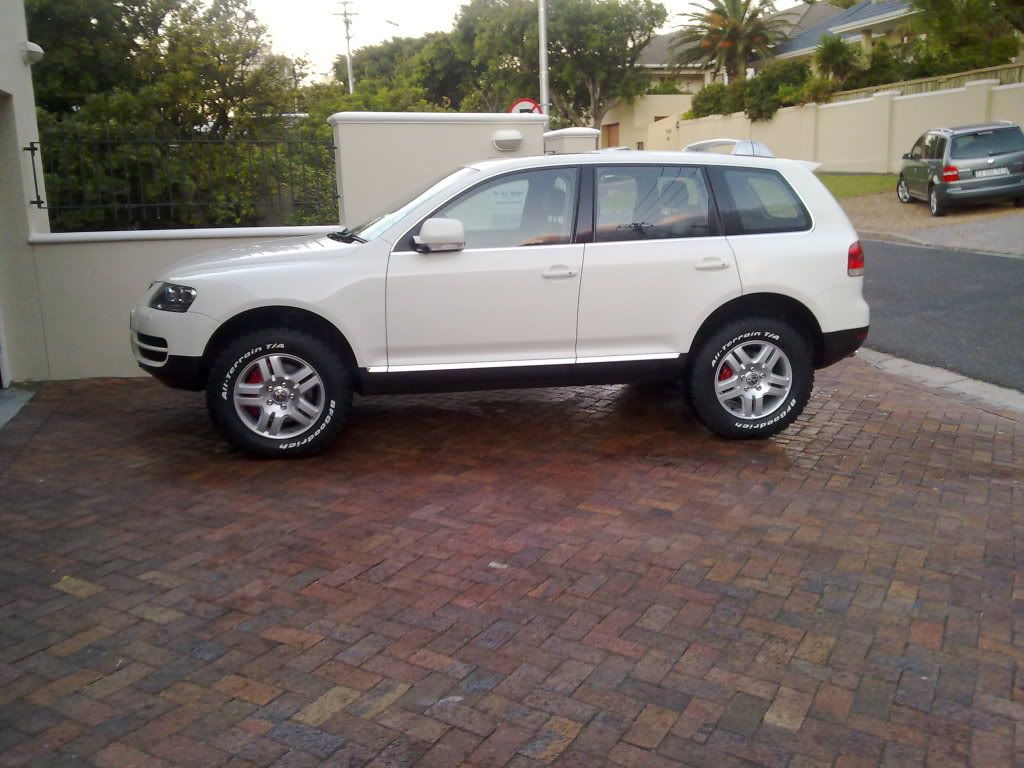

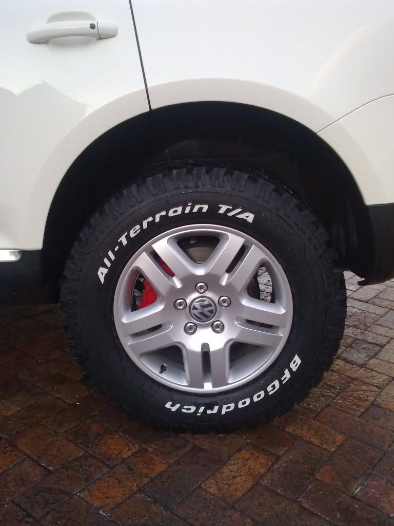

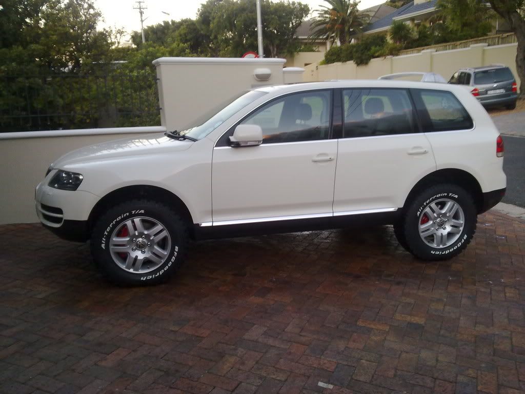

Fitted the BFG All Terrain 265/65/18!! Wheel arch mod required.(5 min job)
Here are some pics.
Looking good!
Here is a link to the Arch mod http://www.clubtouareg.com/forums/f44/295-45r20-they-fit-44913.html
It Really was easy. Step 1 remove torx screws. Step2 drill hole above torx screw that is below the inter cooler duct. Step 3 attach a hoop/U piece on the inner side of wheel arch. Step 4 use zip ties/ cable ties through Upiece and around intercooler pipe and tighten. Step 5 put torx srews back. No Cutting
This moves the arch in +- 1/2 inch or so. Front wheels only rub in sports mode at full lock. Auto mode offroad and extra are clear.
