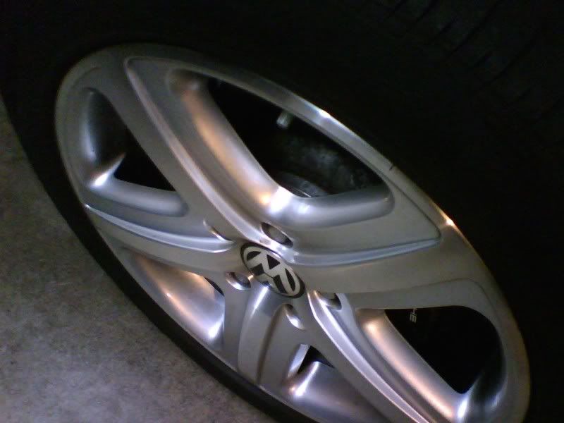

To get that nice wide looking chassi, but not with wheels that stick outside the arcs.... what size spacers should I get for stock 19" wheels?
Don't want it to affect the wear and tear of the tires too much either.
If you put something like 5 cm (2 inch) spacers that aught to change the angle of the tires to the road? But surely as you say, 10 mm shouldn't be of any concern.
Gotta go down to the dealership and check the gaps before hand and orders spacers in time for when my car arrives and ask them to mount the spacers free of charge. =)
Of course not! Don't think I am one of those that tries to pimp cars to the extreme. I rather buy cars that look great standard.
I will probably go for 10-15 mm. Don't want the wheels to be outside the wheel arcs. Seen some cars recently that have too large spacers and it just looks too weird when the wheels are too far out.
