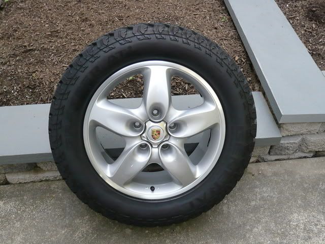

Does anyone have a picture of this 18" cayenne wheels on a touareg, I am thinking of purchasing a set and would like to see them on a treg before I move forward.
Thanks

Yo Linder - that wheel "fits" (bolt pattern, etc) but has an offset that pushes it further into the car rather than outboard. There was someone on here who posted these using nitto TG tires and he had to use spacers - I thought you were in on that thread - his were painted dark.

Interesting, consider both stock v10 18" wheels and the ones pictured in Linder's initial post are both 18 x 8" wheels with a 57mm offset, why would ones push in more need spacers? Sounds like the spacer requirements were more a factor of the size of the tire being used. As for the wheel specs they are identical.
Also, Cayenne wheels will fit the Touareg, they use the same setup, (bolt patterns and offsets).

FYI - the porsche rims WE are talking about have a 47mm offset. Sorry if you didn't know what we were talking about and for what purpose - the 57mm rims with 31.7" tires get a little tight on the inside so 47's will allow more room, 10mm is a lot when it's just rubbing.
Actually, the Porsche rims pictured are indeed a 57mm offset. You can see it in the picture. Also, I have confirmed it with the seller as well.
I perfectly understand offsets and tire clearance. The op only aksed if anyone has pictures of this wheel on a Touareg, not a discussion on which tire size and clearances.
Really, which picture? There are 2 Porsche rims above. The top one in OP is 57mm as I stated and the other one from porsche I showed is 47mm.
The VW rims are 57mm, Porsche rims in first post 57mm, and the Hartman wheels porsche rims are 47mm.
So, again the ones we were talking about, not the ones in the OP, are 47mm porsche replica rims. We left those already. Sorry to confuse
