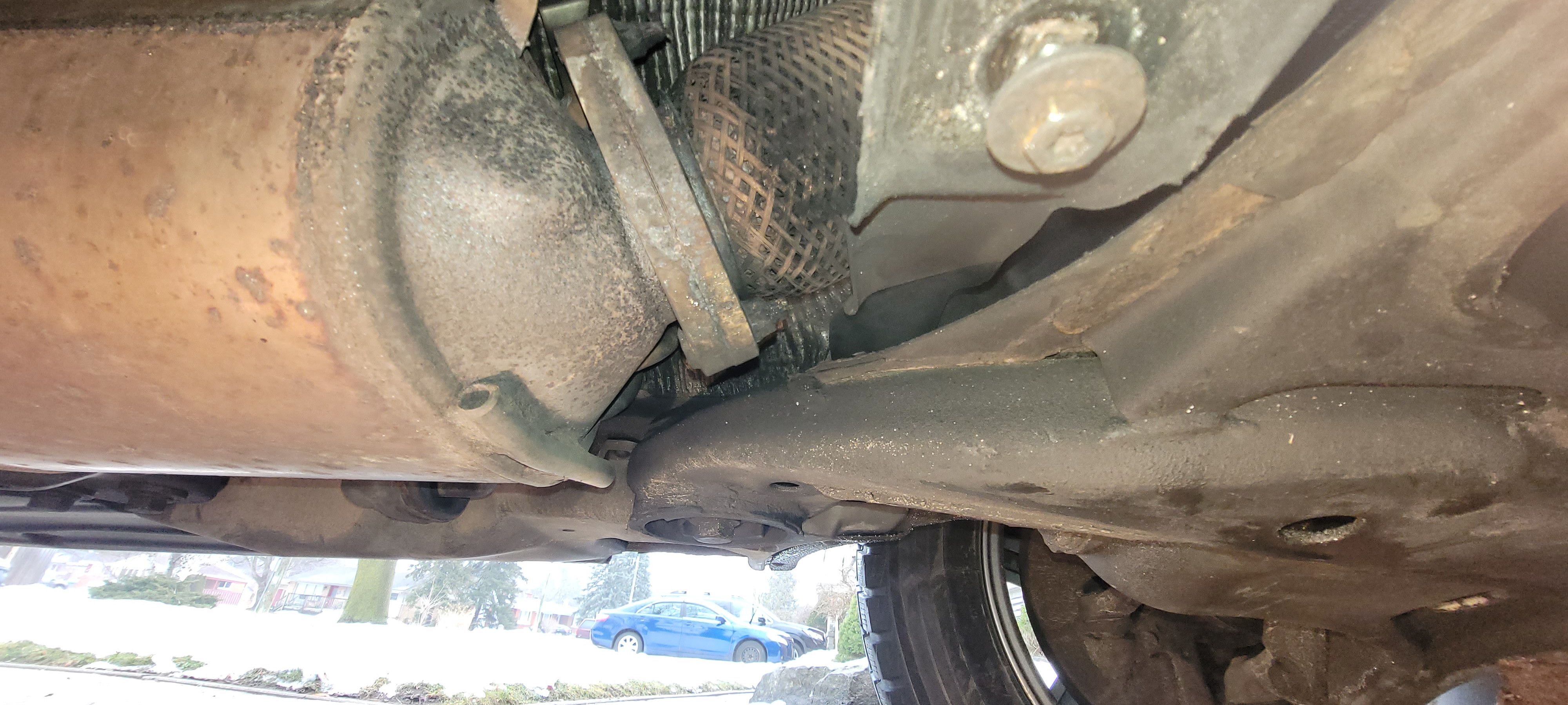

Here's an example:
I smell something.....
I look around the engine bay, can't find or see anything.....
I crawl under it....
Disclaimer: Zero eyeball lube was used in this diagnostic session.
[/QUOTE
Maybe you're blind :sneaky:
Here's an example:
WAIT! TOUAREGS HAVE AN UNDERSIDE?
