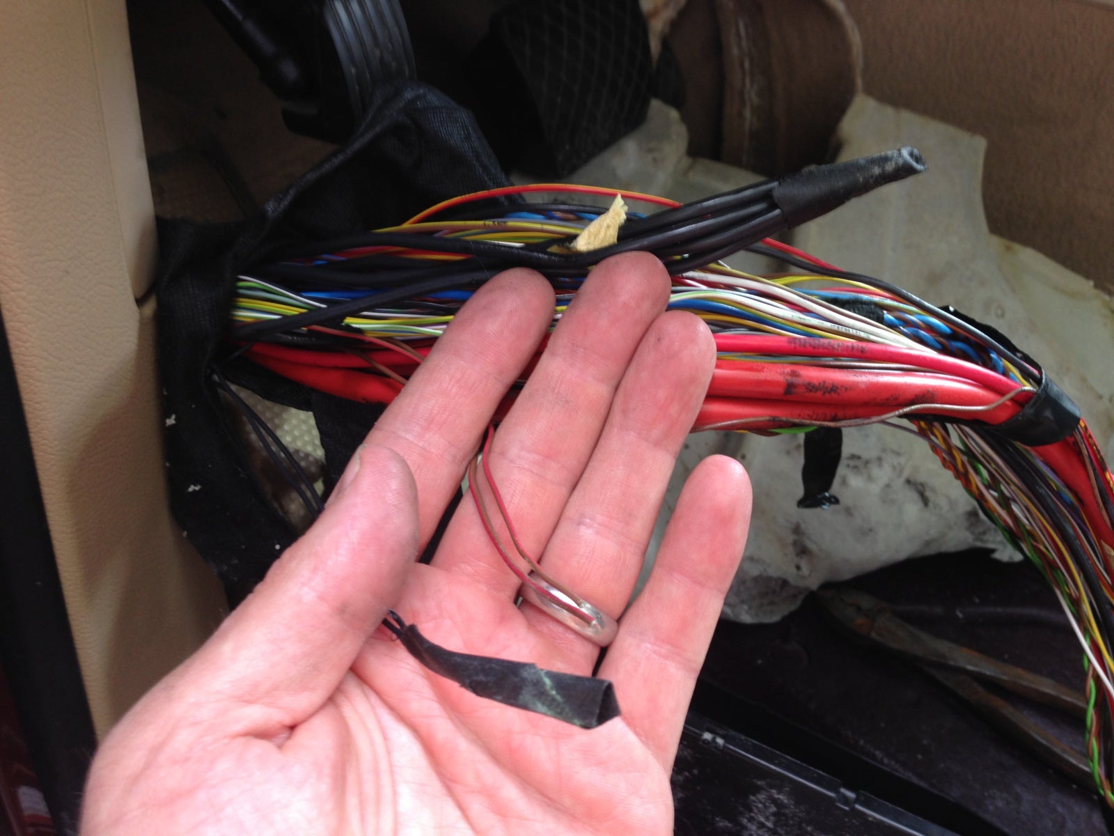

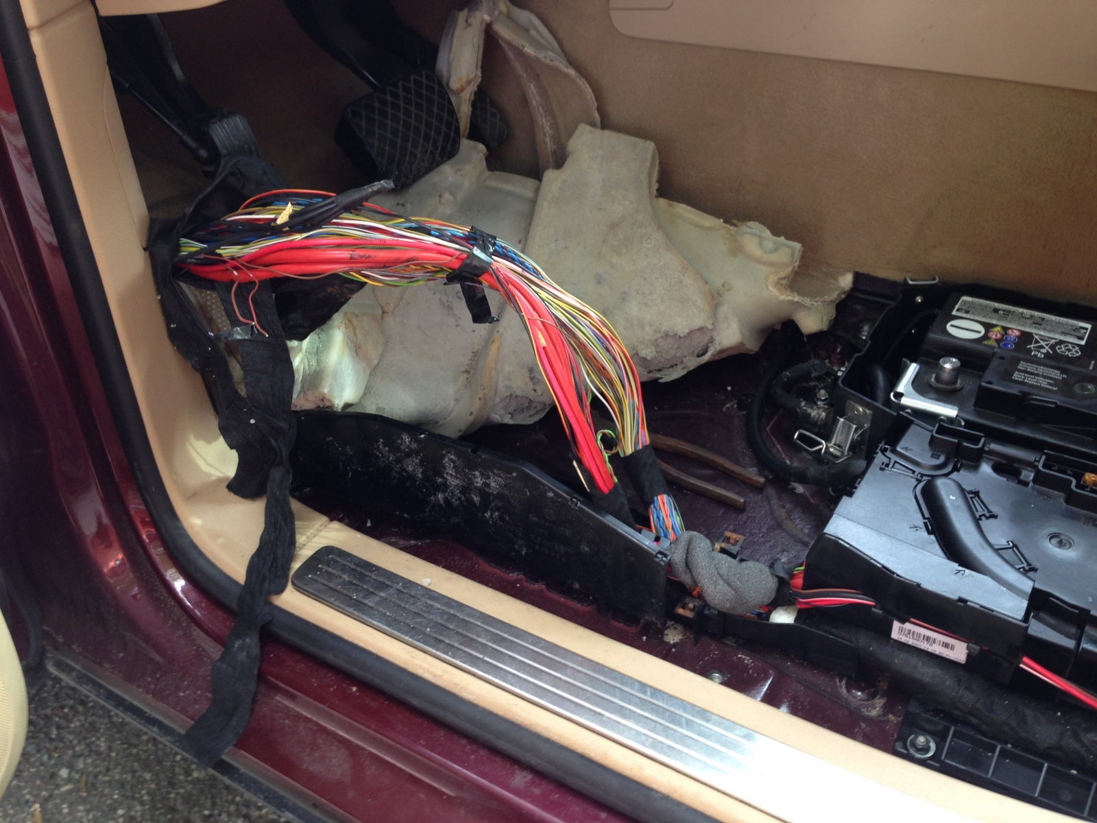

Hi all.
I have a touareg 04, 220K km, 4,2 v8.
I have the following problems:
Battery drainage.
I think is linked to the kessy, And the diagnostics says there's a failure with the passenger door.
I've read, that the door handle can be disabled by disconnecting the connector for the door handle behind the door panel.
Could someone confirm this?
- Occasionally i can hear clicking noices underneath the panel, and i assume this is the kessy-module?
Furthermore, i have often (occasionally) Brake fault stop engine. When i turn the the ignition on and start the car. When i shut the engine down and start again the fail reading in MFD disappeared.
I've got fail readings on the ABS, witch i can read possible is the differential rear stepper motor. Im thinking about removing fuse 23 in the left side, witch i've read shuld be the one powering the rear stepper motor? Im never off-road and will not need this function.
FURTHERMORE i've read, a lot of people have brake failure issues because of bad soldering/water in the drivers footwell (left side). But i havnt been able to find information. Do you just cut the carpet between the drivers seat and the B-post, lift up and re-solder the wiring?
The breakes turned into complete sh**, after the shop changed discs and pads, very squeaky and bad, the parts are ok, and the brake fluid was changed and air was removed. Has someone experienced simultaneously situations?
Best regards, and thanks all for this nice forum.
