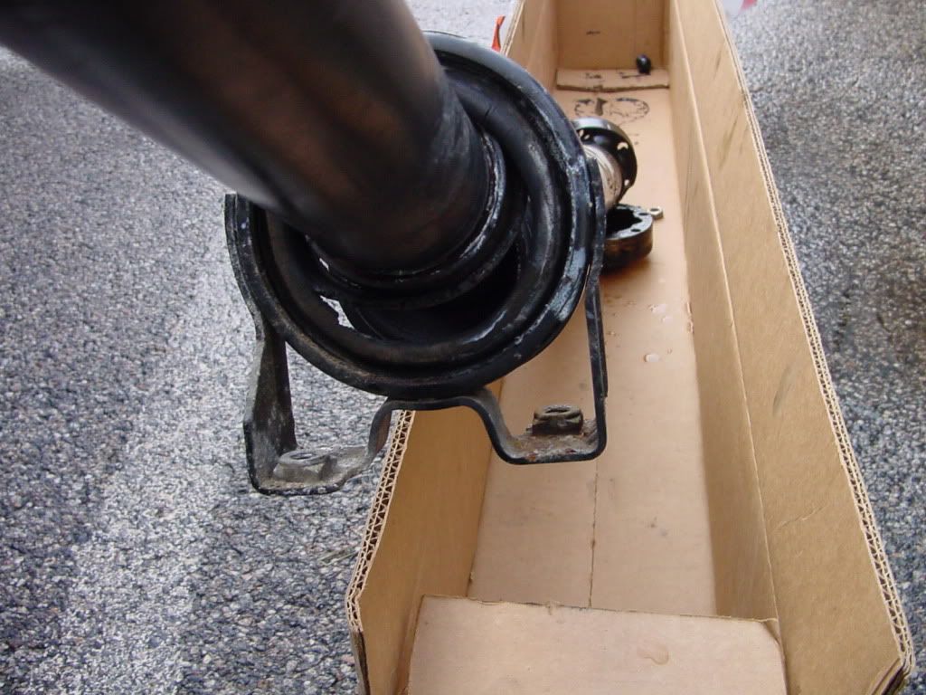

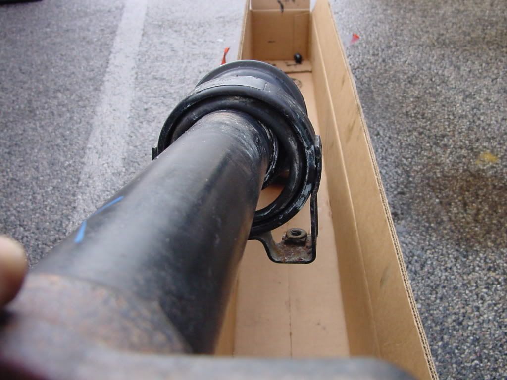

This is the rear half of the driveshaft and coupler
This is the part that typically fails. You can see the shredded rubber bushing. The ring to the left should be connected to the bearing.
The new one looks like this

If you compare the two pictures, you can see a slight variation in the carrier housing lip and center rubber bushing. I assume the outer rubber part is heavier duty also.
The more I look at it however, it looks like the metal housing could be oriented 180 degrees on the new one compared to the old one. Hmmmm.
Nancy
Nancy
I think that's just an optical illusion. If you visually rotate the new one around it looks like it'll be in the same position as the old one. (The two 'feet' on each unit have opposing positions.)
