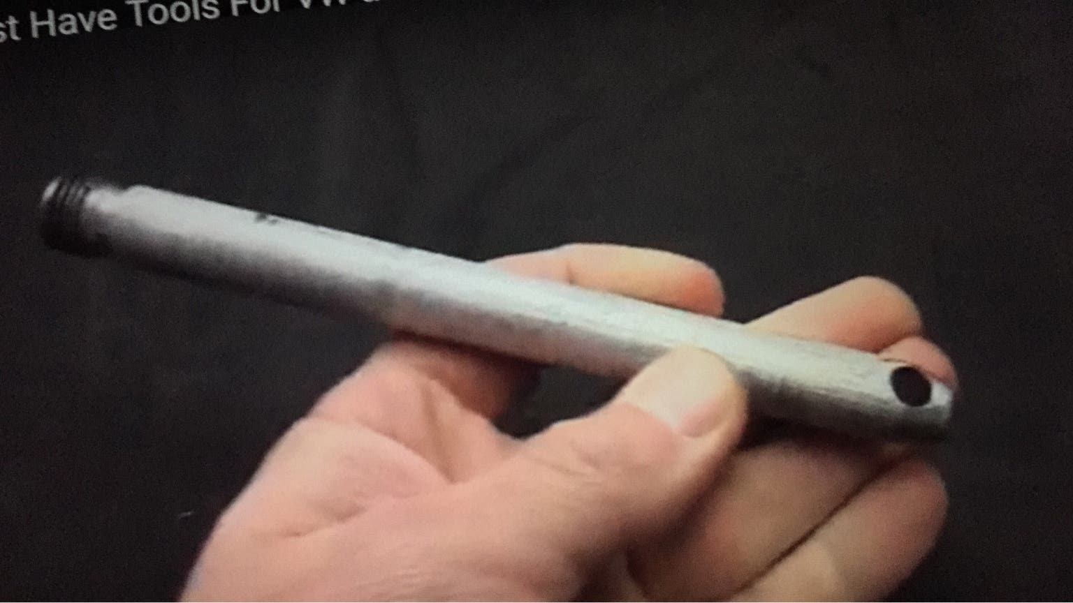

Just discovered this helpful tool in the trunk.
Never heard of or used one before. If you're wondering what this thing is here is a video
My T2 had one but I didn't discover what it was for until after I had changed my first wheel. My current T4 didn't come with one (ex VW executive fleet). The dealer said they weren't included and said none of the new cars on the showroom floor had them (sounds like BS).
I ground the head off a long bolt to make my own. 8mm thread I recall.
What the How-To video doesn't show: Before you take off the wheel, undo one bolt and insert the tool. It makes it easier to remove the wheel, as well as putting it on. Otherwise the wheel wants to fall off as you loosen the bolts.
