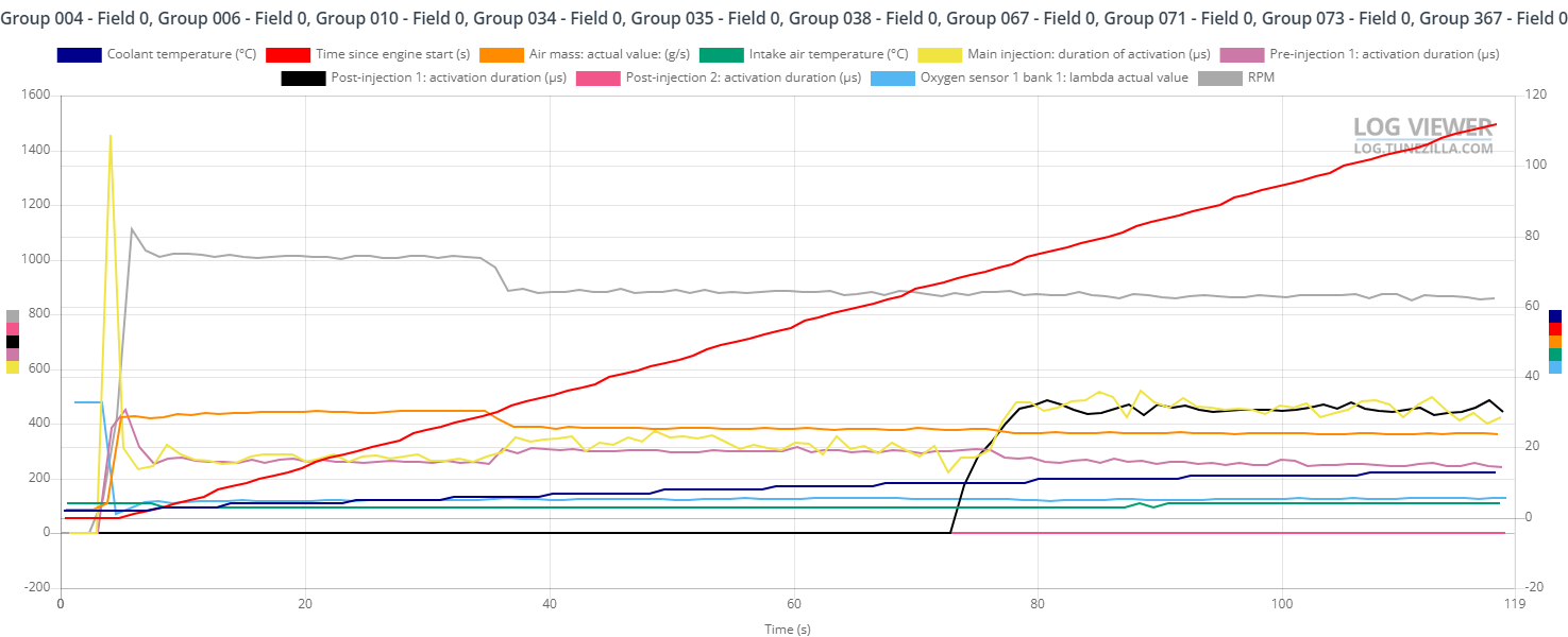

I have posted this to Tunezilla as well BUT I tried putting the stock tune back on and still got the smoke (and, interestingly enough, no codes!). I am back to the Tunezilla tune.
I did NOT delete the swirl flaps even though that is part of the tune. Would this cause a rich condition?
Attached is a log of the injector pulses versus time and temperature. Once the car was fully warm, there was still smoke, so it is still running too rich. I tried doing the CODE thing but there is too much data and the website choked on it.
Bob

36 degrees out this morning. Smoke about 60 seconds after the start up. Look at this log:

Note that the Main Injection time goes from the 300 microsecond range to the 500 range and the post injection 1 time goes from 0 to 450 or so. This is also when the smoke starts. SO, to me, it looks like the computer is dumping fuel into the engine for some reason. At 60 seconds, I would expect that to be some sensor is giving wrong data or is missing (deleting the cats and DPF also deletes a LOT of sensors) and the ECU is trying to make up for it. As I said before, when the vehicle fully warms up, the smoke goes away. UGH!!!
And, there are still no codes.

Well yeah, its dumping fuel because its in a warm-up strategy, I'm not sure that means much
