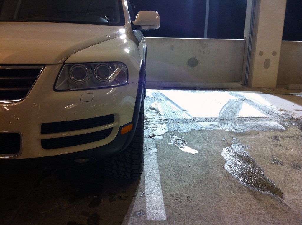

--I think I heard the tires rub one time... I tried lots of full lock turns back n forth and only heard some slight tire-on-plastic (fenderliner) rubbing while at full lock and the suspension drooping (making the u-turn to go down the parking garage levels)
As others have stated, this tire size requires a very slight (5mm) spacer on the front to clear the upper ball joint bolt. I purchased mine from AkataSpacer on eBay, $39.99 shipped. The quality of the spacers are great, not like many other cheapo ones I've seen. At 5mm, the factory "centering" portion of the hub still sticks through enough to center the wheels, and the lug bolts still get enough turns to not require replacements.

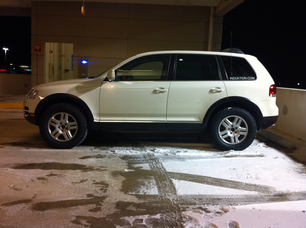

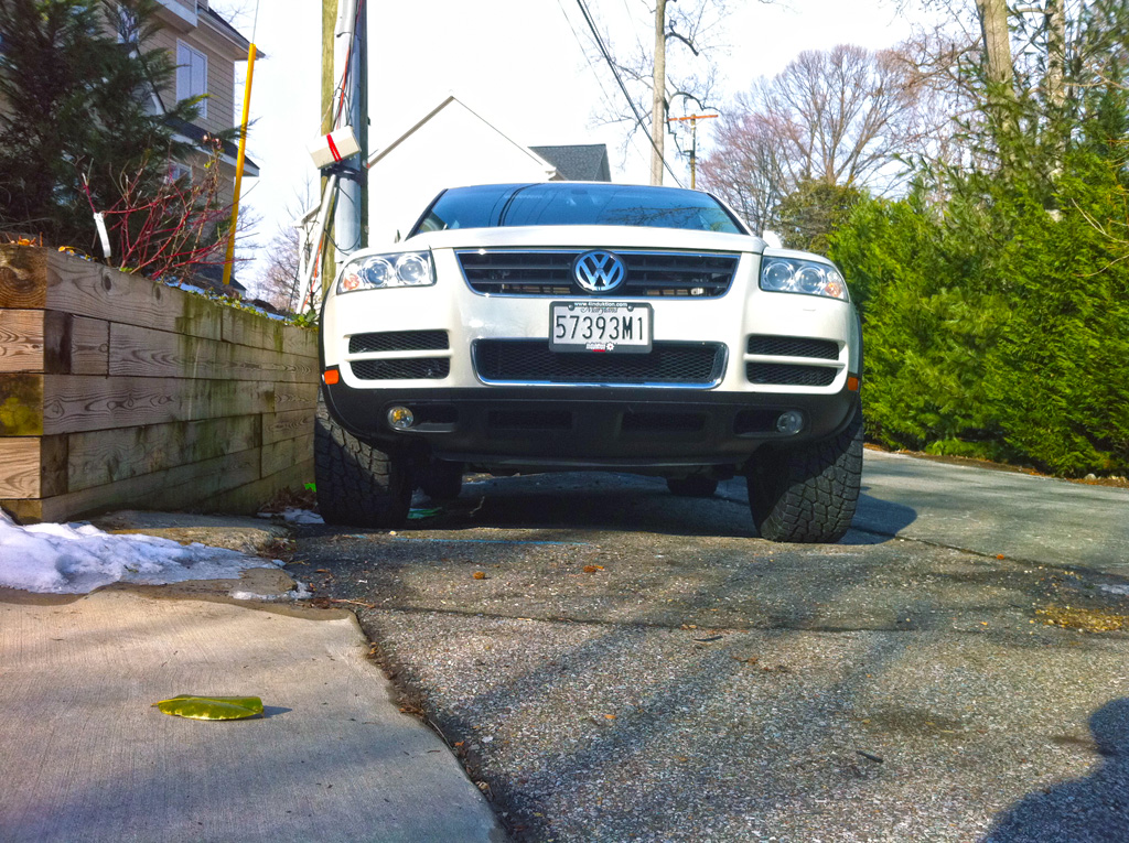

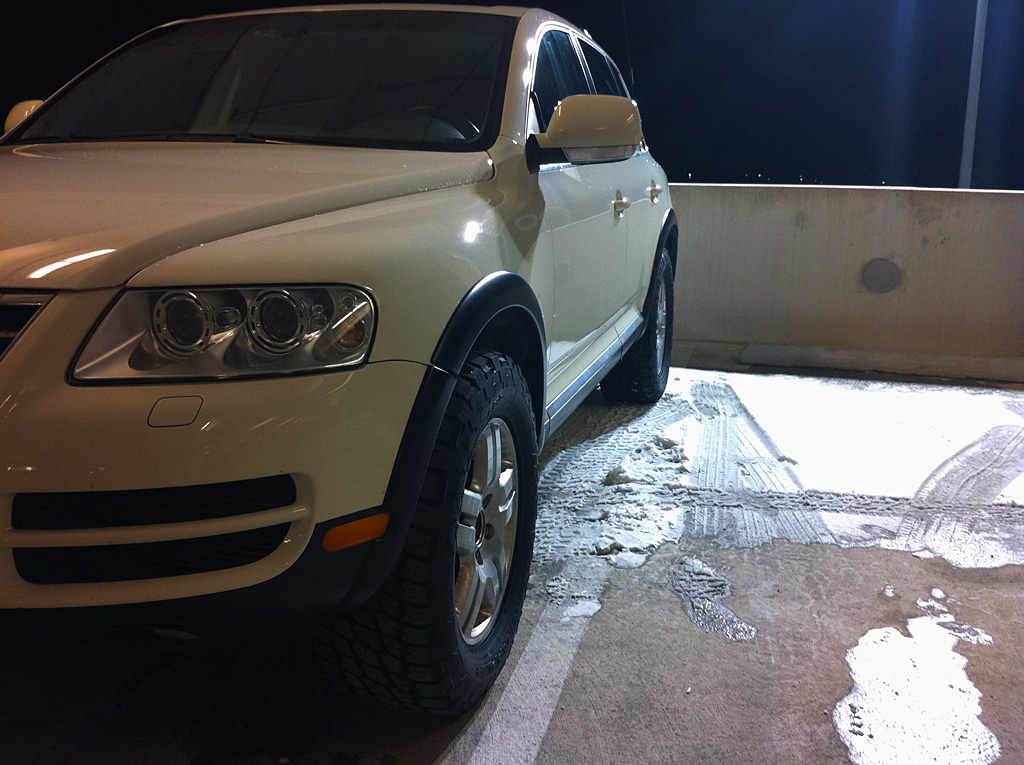

Now onto the pictures... I attempted a DIY spray wash, but at 32°F I only lasted a few minutes of high-pressure soap before calling it a loss and running through the automatic laser wash.
"Profile" showing how far they stick out
and me being artsy with some CS5 "HDR Tone Mapping"

The only time I think I've heard any rubbing has been with the wheel turned about 3/4 of the way in either direction and slowly backing up... I have noticed it maybe once every 3 times I reverse out of a parking spot for just a brief second. Other than that, it seems good.

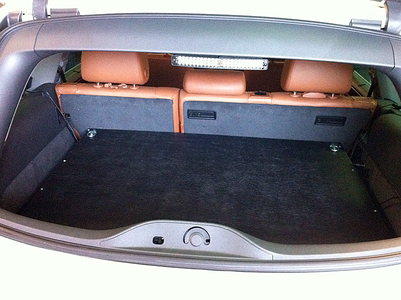

Next step w/ the 285s, full size spare... The tire should arrive tomorrow, so I spent some time this weekend working out a "storage" setup for it...
The basics:
23/32" Sanded plywood; the top deck is roughly 43"x32" and the sides are ~12.75" tall
I sprayed the top/sides w/ Plasti-Dip to give it a somewhat grippy texture; not sure if I'm set on this or not, I might add carpet instead. The "inside" is sprayed semi-gloss black. I also added 4 300lb tie downs on top to replicate the factory tie downs, and then added two more on the inside to attach the shelf to the factory tie downs with turnbuckles. Unfortunately it seems that Lowes / Home Depot around here don't stock 12" turnbuckles, so those still have to be ordered. All the edges that face the rear of the truck also have 3/4"x3/4" aluminum edging to make sure they don't get damaged while loading stuff
The opening underneath allows for my 285/60 spare and roughly 10" of room to the side of it. I'm having a heck of a time trying to find a plastic bin that is roughly 10"Wx12.5"Hx30"D, so I may end up building another vertical wall and create a sliding drawer. I also still have to add my Maglite hold-down and fire-extinguisher hold down.
What's going to take the place of the factory spare? Eventually a second dedicated "house" battery that I can wire all my lights, scanner, CB, inverter, air compressor, etc to... But I still have a few other projects before that takes place. I think I might also replace the section of floor that covers the opening into the spare tire well and add some hinges for easier access...
A few pics:
