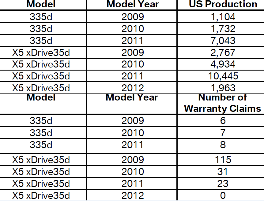

BMW and Mercedes, (chevy and ford which use the Touareg's hpfp) all have had failures, just not as well known, this is significnately more a US issue than canada, as we have the same lubricity standard as in Europe. Where we find failures in canada, is if the fuel stations mistakenly put gas in the diesel holding tanks, and of course excess water or moisture in the fuel.
Here is the data i pulled off NHTSA website in regards to the HPFP investigation. This is in regards to BMW HPFP failures. Mercedes somehow got away with not submitting any data but i know of two people at least in the us that have had similar failures.

Thanks SamT...on all honesty the numbers don't look outrageous, except for maybe the 09 X5 numbers.

there are way more up to date numbers i just haven't been following the data or had the time to compile it. i believe in total since the new CR TDI was released there were approx 500 HPFP's that imploded which were known not to be a misfuel. In total including misfueled TDIs there were 5000 cases where VW comepletely replaced the fuel system in TDI's accross the USA since the 2008 Release of the CR TDI.
The bmw numbers as far as i know are cases which were known not to be missfuels. So % wise the margin of failure is fairly similar considering VW sells way more TDI's.
