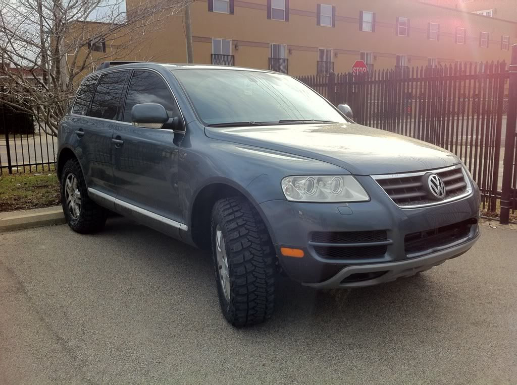

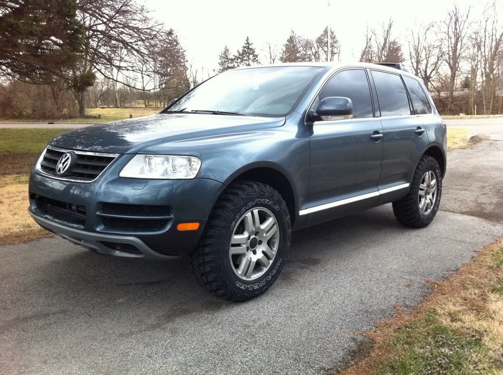

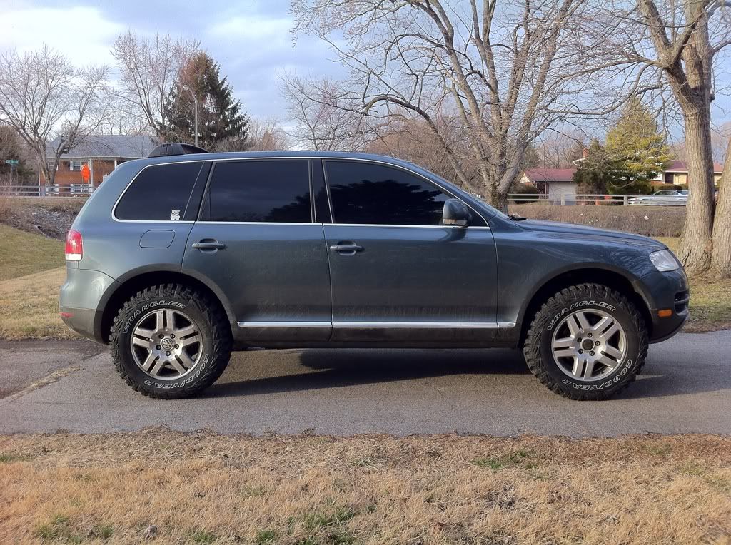

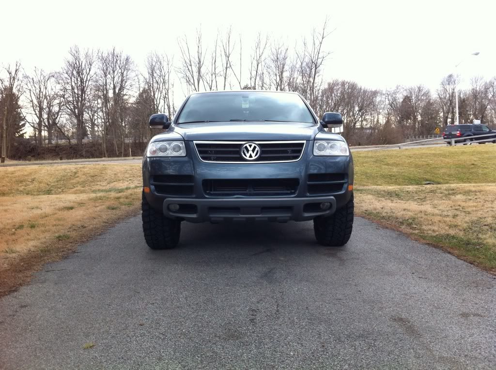

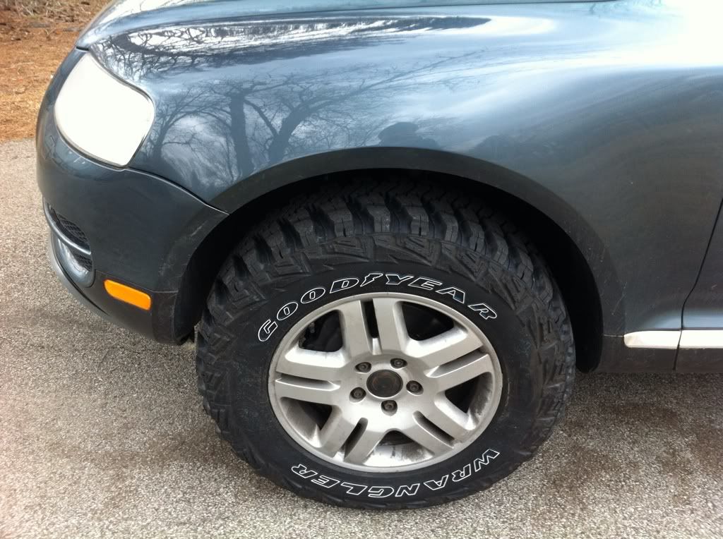

I ordered 275-65-18 Wrangler MTRs and had them installed on my 04 Treg and I love it! there is some road noise but they are incredible smooth and ride very well! The most surprising part is that they only rub the inner fender in reverse at just the right angle. I couldnt believe I didnt have to trim anything!

VERY nice!
And at 32.1 inches overall diameter I think you may have just set a new record for the largest tyre in a Touareg wheel arch as I think the general opinion was that 31.5 inches is [was!] the maximum

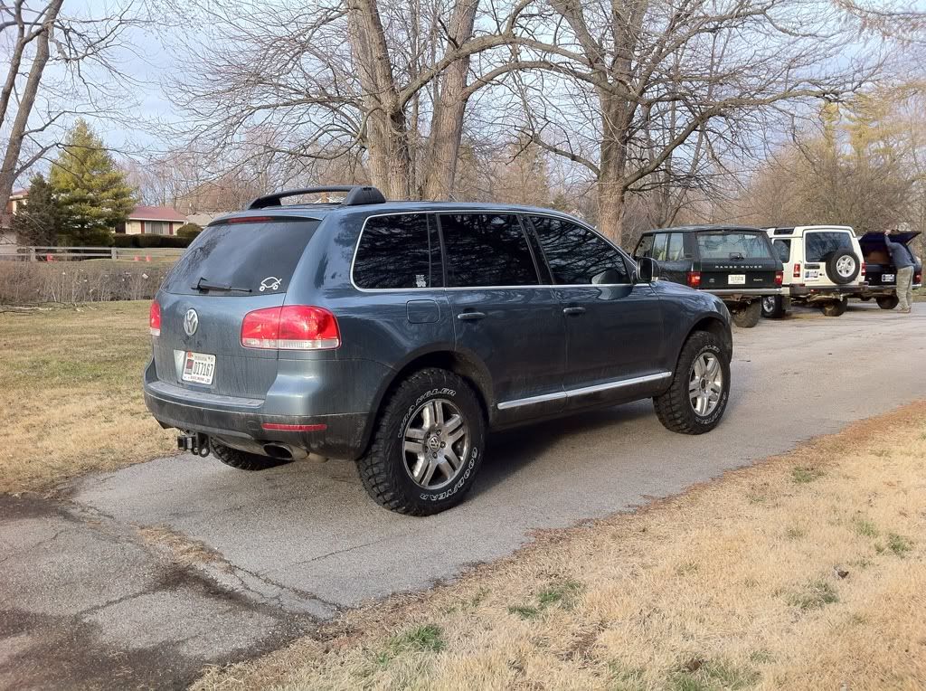

I liked the black Range Rover Classic in the background too. I had a couple from '85 to '95. It looks like it is on a 2+ inch lift?
Don't forget your speedometer will now be out with almost a 10% under-read. Check your speedo against SATnav.
With that many Land Rovers he's a glutton for punishment!!

The last number in 275/65/18 signifies wheels size..so they are 18's. There is no way they would fit a TDI, as the intercooler vents in the front wheel wells would definitely rub.
