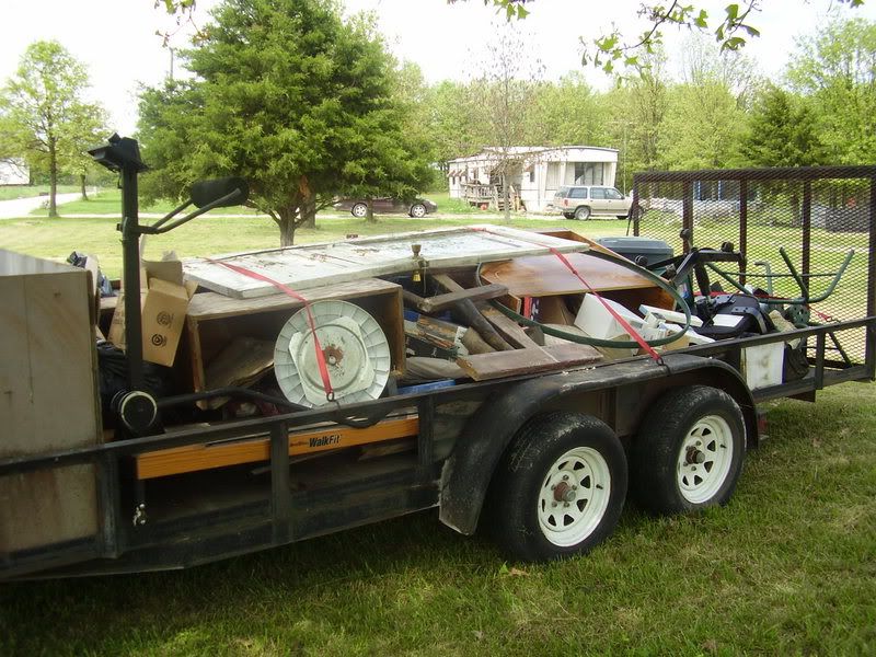

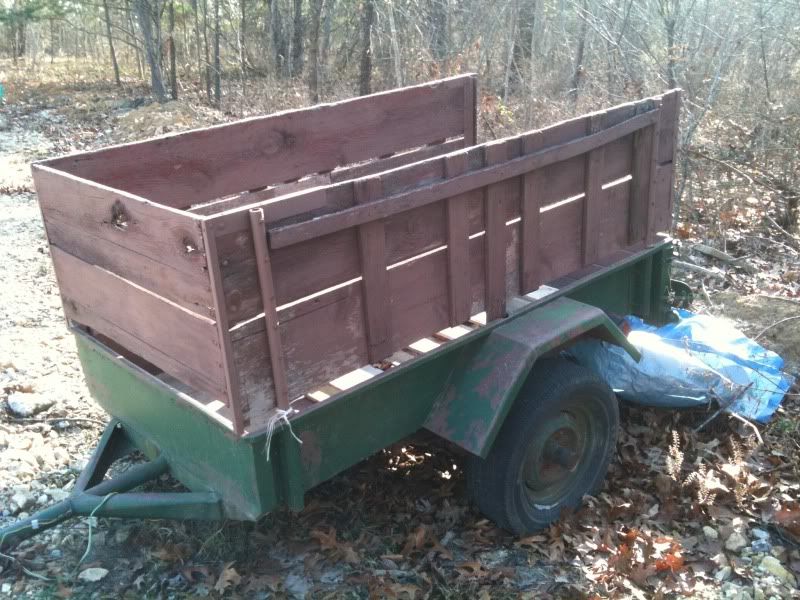

I tow an 18 ft flatbed, a 5x10 enclosed haulmark, a 1930's vintage utility trailer (for sale) and an occasional Uhaul with mopar muscle cars on it

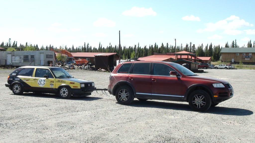

A couple of my towing setups...I have a few others which I'll post one of these days
