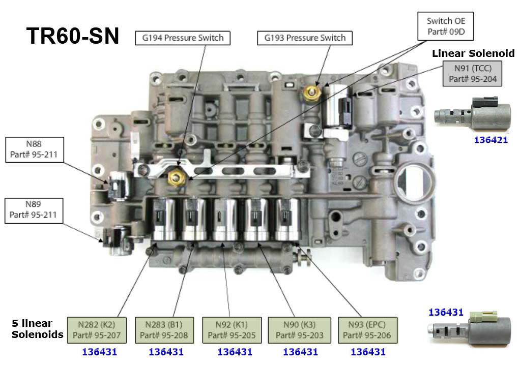

I think I will drop the transmission pan, I will replace the filter, also I will drop the valve body from the transmission and replaced the fluid pressure sensor since it is coming up as an error here:
(17229 - Transmission Fluid Pressure Sensor/Switch 2)VAG 09D 919 081 - Automatic transmission oil pressure switch.
This sensor costs like $55, I am almost sure it is the cause of the shifitting issue.
If you want to do it right, do it systematically instead of loading up the parts cannon. Your code tells you it's an electrical issue. Until you source wiring diagrams and validate contacts/wiring, you could potentially be replacing a working switch and still have the issue.
The fact that it's intermittent is also typically indicative of a flaky connection. You should be able to log/monitor its measurement to see the signal drop etc even before inspecting the actual wiring.
I think there is a misunderstanding on "intermittent" , regardless of the wording the car is not drivable as the transmission never shifts past 4th gear. I have to drop the transmission pan anyway to do a fluid/filter change. Those pressure switches are cheap, they range from $38 to $55, since I am already there in the transmission, I think it is worthy to replace them anyhow.
You have the tool to either confirm my misunderstanding of the word or to validate your assumption without taking anything apart. It's not my vehicle or money so your chosen approach won't affect me at all. You asked for input, it's been given. Hopefully you don't guess wrong and end up wasting both time/fluid/money if replacing an inexpensive switch doesn't solve the issue.
This is all correct, don't get me wrong, I truly appreciate your input, it is valid and helpful.
Upon resetting the error it immediately comes back, as I mentioned, I need to do a transmission service anyhow.
I will definitely check all the connectors and wires by the transmission as well.
Thank you.
I believe you are correct, all my research using VCDS and online resources points to the oil pressure switches. G193 and G194 pictured below. I will do a transmission fluid service and filter, then replace them both and see what happens.
Yesterday I replaced both G193 and G194 Pressure sensors. Reset all DTCs with VCDS drove the car, same issue. When I get to 4th gear, it only rev up or down.
These sensors were identical, there was no information which one goes where.
I did scan back after a quick drive, I got only this message related to transmission.
P0845 - 003 - Electrical Malfunction - Intermittent - MIL ON
#16 · (Edited)
SaVAGeSoot
i did warn you in #6 and #8 above, but you wanted to do it your way!
I told you to log signals and to check WDs.....
What's your plan now? :unsure: "

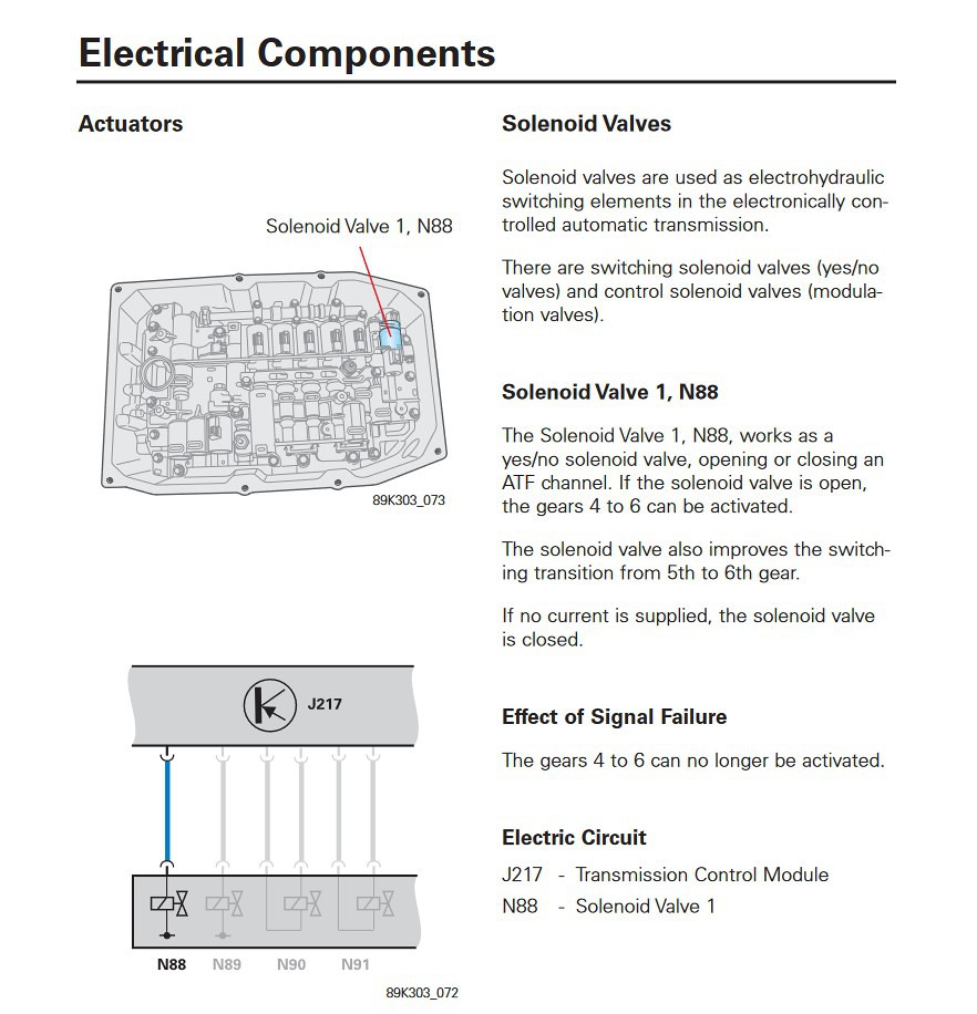

I Did get the SSP however it did not offer much of clue. I am still researching... If you have any additional advise or input it is greatly appreciated.
For now I found this information on the SSD I believe it is something worth looking in to it.
Thank you.
09D TRANSMISSION SSD
There are clues in all of the above. Pay attention to "electrical" malfunction.
Pay attention to you need WIRING DIAGRAMS
Pay attention to the SSP.... how are these two sensors wired? See the shared ground? So if only one of the two is giving you a code, what else could it be if it's not THE GROUND? Could it be "the other wire"?
Did you log signals like I suggested to see what it reveals?
Did you go to erwin or mitchel or your library or anywhere to obtain wiring diagrams to review?
