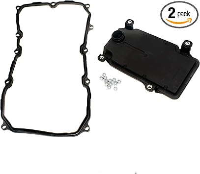

0C8 325 435 (transmission strainer):
Vaico V10-0435
Other aftermarket manufacturers:
Meyle
Topran
0C8 321 371 (oil sump gasket):
Vaico V10-2285
Meyle
Topran

Seeing as how this thread is still active, the best deal for the transmission filter and pan gasket is NAPA Auto Parts. The kit is $36.99 and is made by the same manufacturer as the factory filter.
