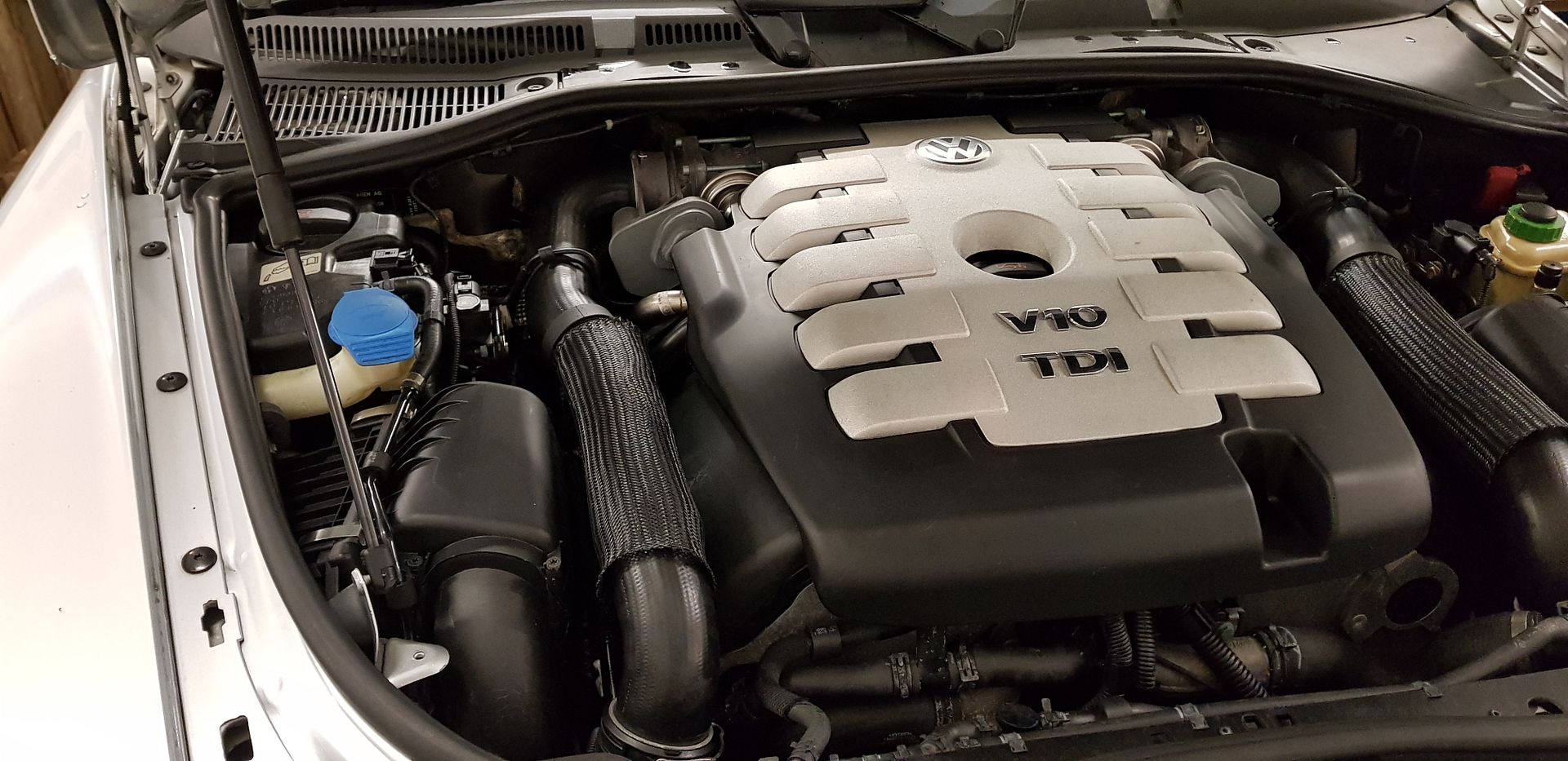

One V10 engine!

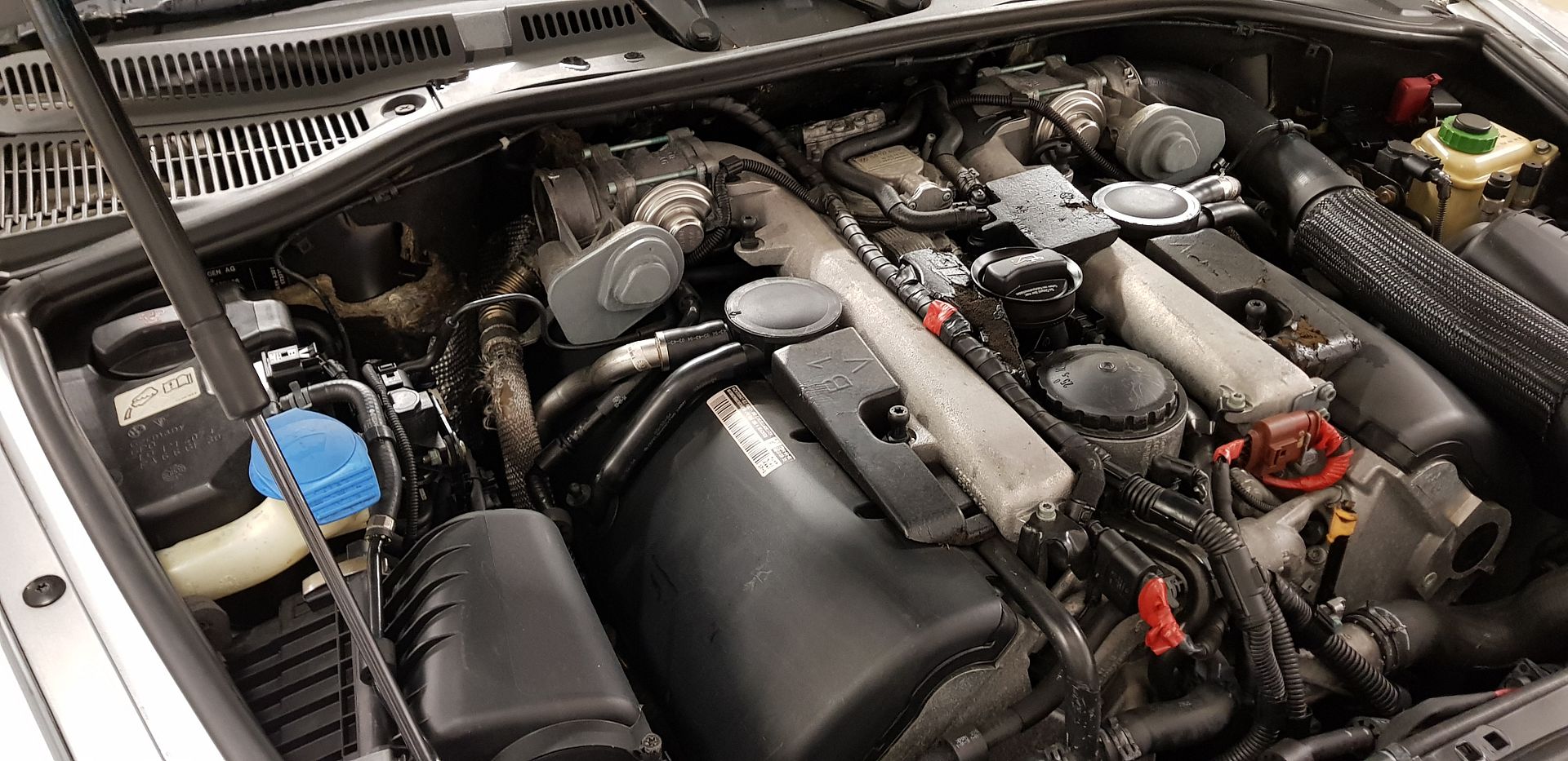

Remove the dipstick, cover and boost pipe for the right hand side.

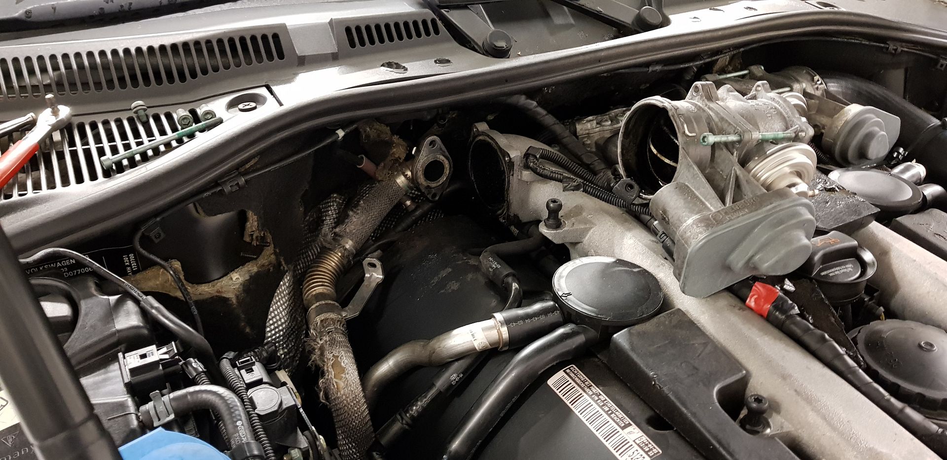

No, you can't see the tandem pump yet. It's buried down on the back of the cylinder head.

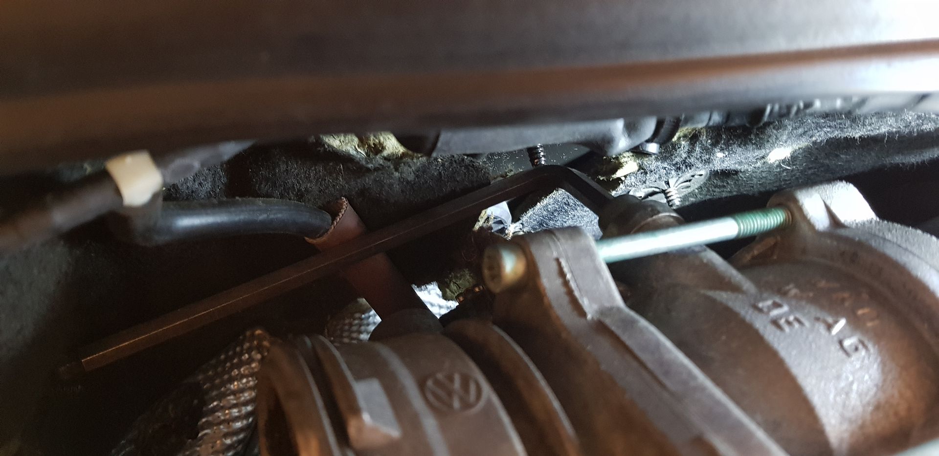

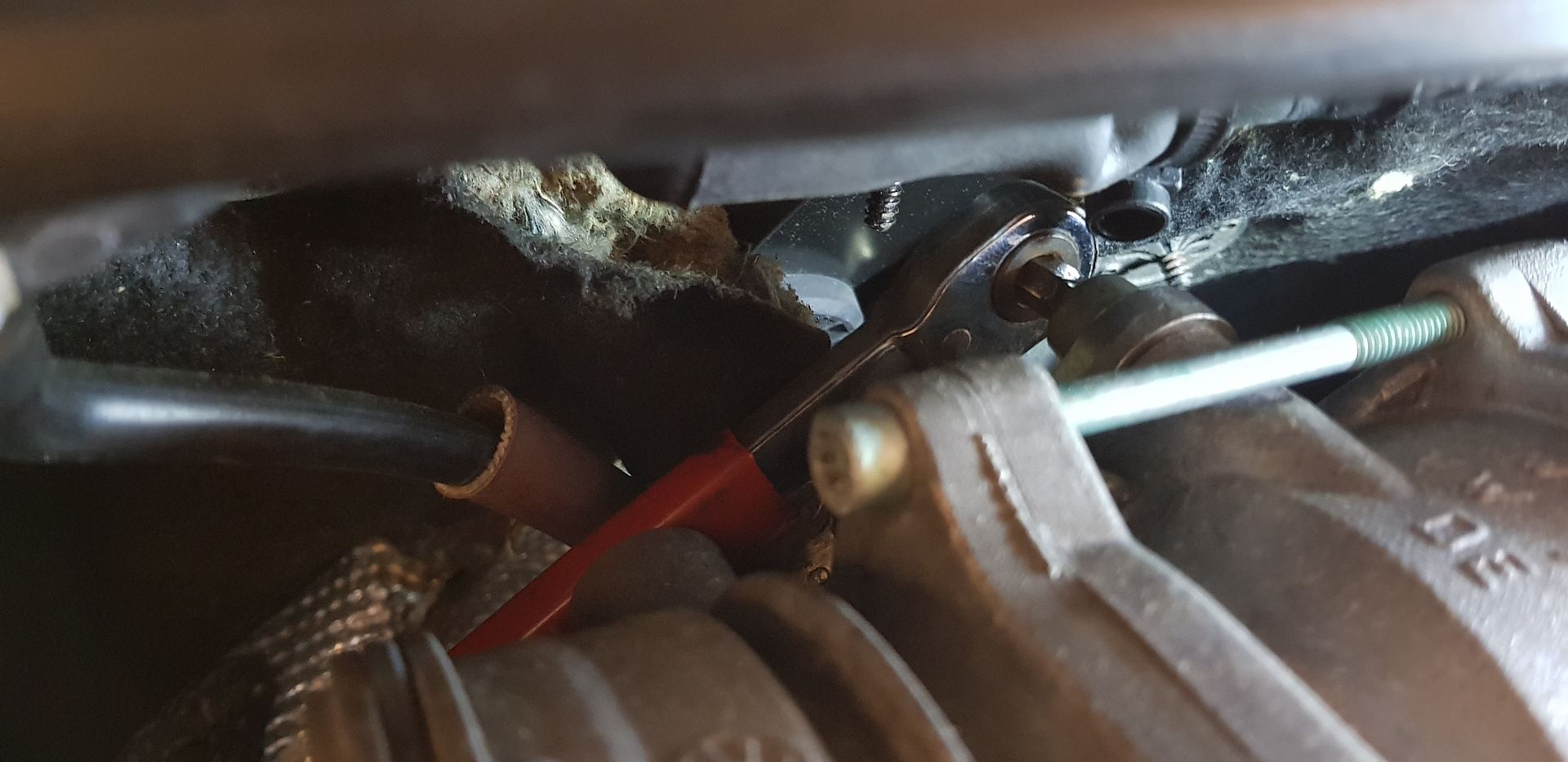

Here's the throttle body. It has an EGR pipe bolted to the back of it with 2x M8 Allen headed bolts. Access to them is limited and not helped by the loom mounting spike on the bulkhead. I moved the spike a little to help.
I started off with the normal allen key on the lower one but it was too tight on the top so I used a handy little snap-on ratchet.
There is a metal gasket on the EGR pipe flange but it's held on with tangs so it shouldn't drop off/out. I removed it later on once the throttle body was out of the way - just in case it wanted to try to disappear!

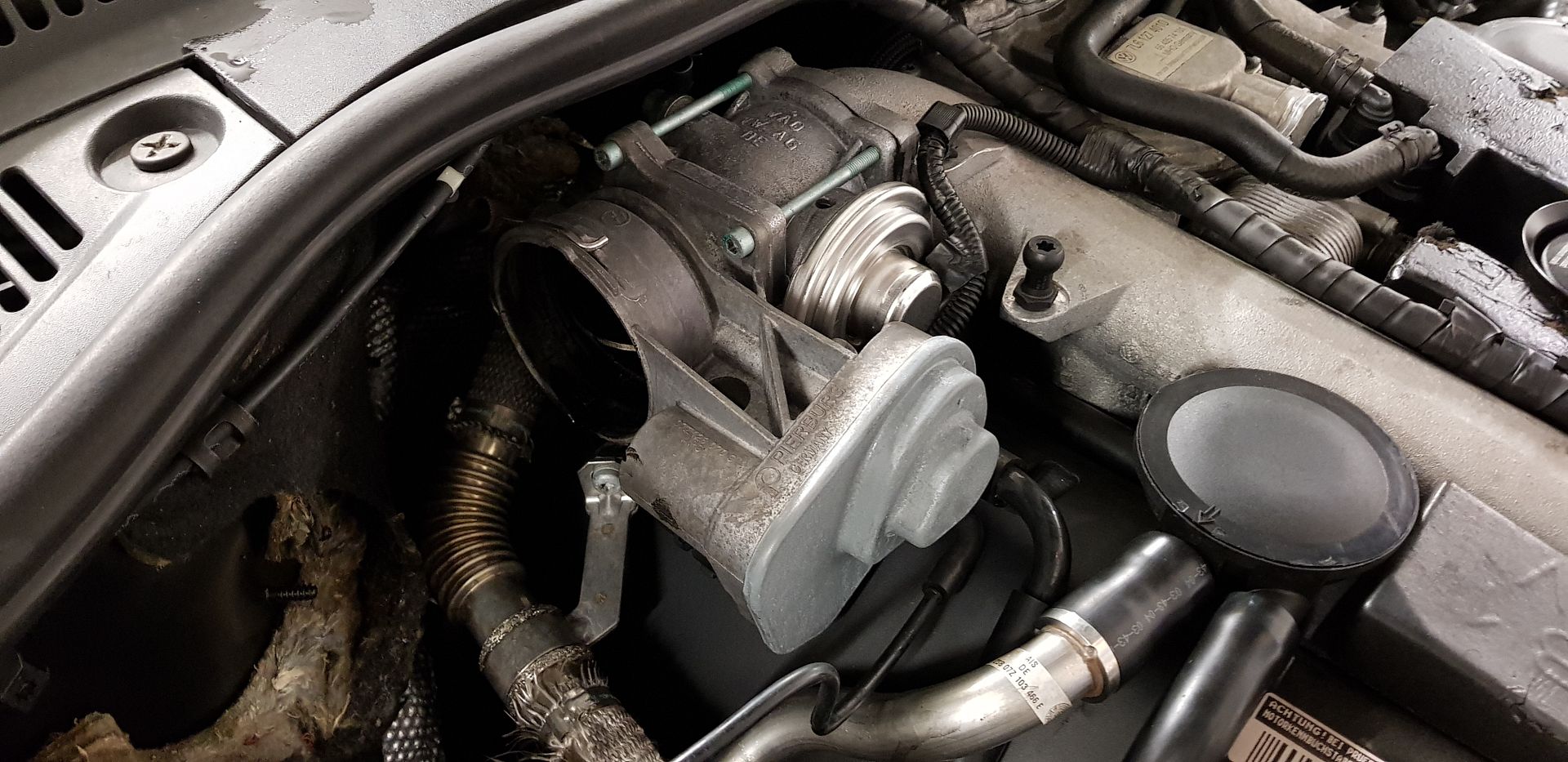

Now remove the four M6 long allen bolts that secure the throttle body to the inlet manifold. You don't need to pull them out, just undo them so that the throttle body comes away.
The throttle body seals onto the inlet manifold with an o-ring so you don't need to worry about any gaskets there.
There is a small loom connected to a black mounting bracket that the lower two M6 long bolts pass through. It runs behind the throttle body. Gently prize it away and the clip will come out without damage.
Also, the EGR pipe bolts to the same support bracket with a small torx bolt which needs to be removed.
Once the throttle body is moved out of normal position, you can get to the electrical connection and vacuum pipe. Be CAREFUL with the electrical plug. I have seen countless plugs destroyed by people trying to use tools to release these. It's easy if you do it this way... push the connector further on BEFORE you try to release the clip with your other hand and it will come off easily. You will not get it to release easily if you just try to release the clip. These clips are designed to be under tension from the seal.
Once these have been disconnected, you can remove the throttle body out of the way.
I hooked the vacuum pipe up over by the bonnet hinge so that it wasn't in the way.

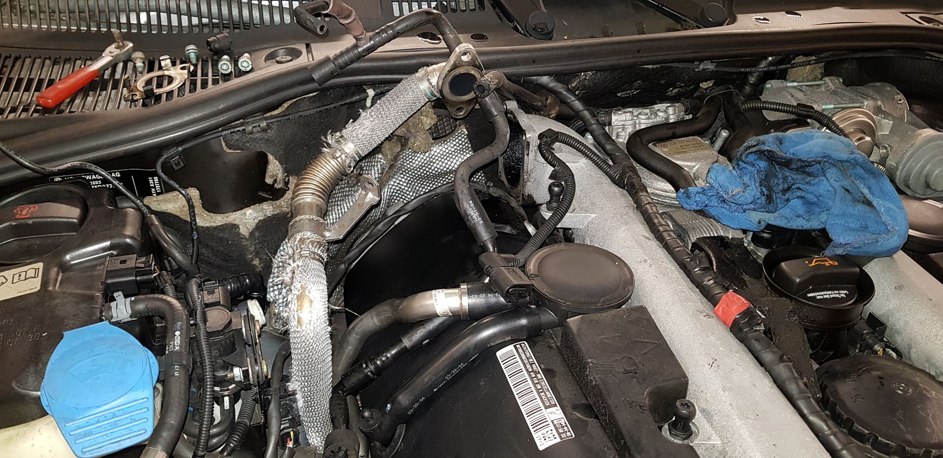

Once removed, the EGR pipe has move 'give' and you can pull it up a bit and gain clearance to the back of the cylinder head.

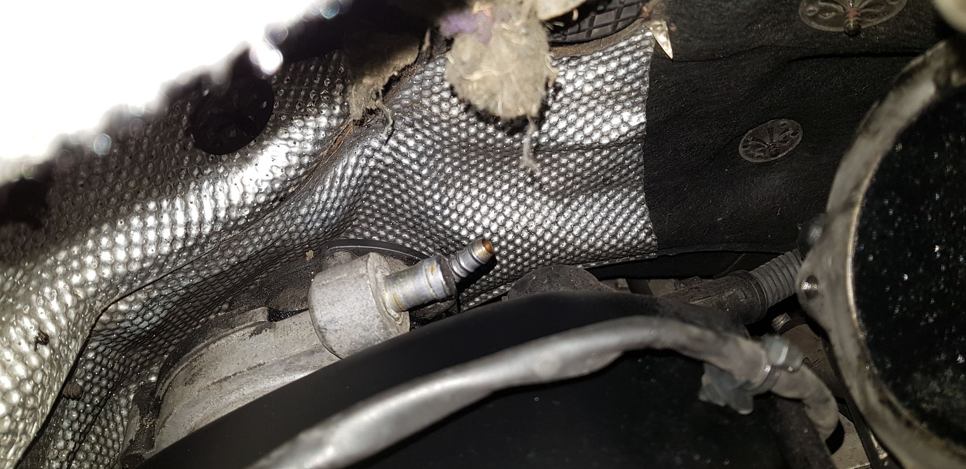

Now you can see the tandem pump and some of the pipes going to it.

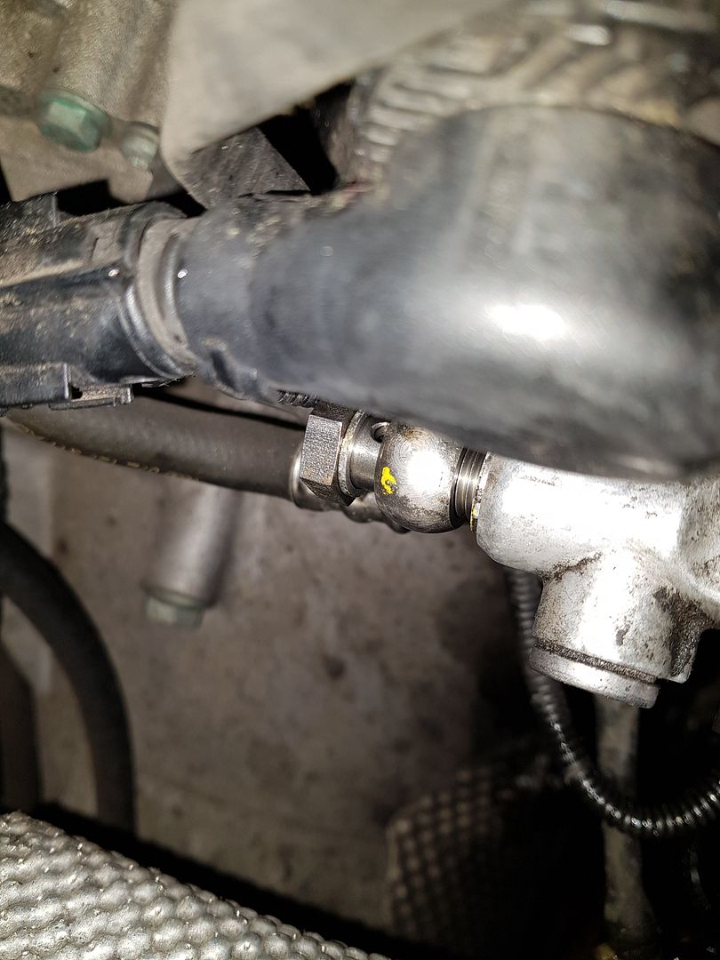

Now you have the fuel outlet pipe to disconnect. This is the pressure side.
It's a 17mm banjo bolt and the washers are free to be Lemmings should they get the chance!
You can't see this bolt. I took this photo while I was putting things back together to ensure that I had both washers in position before tightening it up.
I used a stubby 17mm spanner to loosen it as there isn't enough room for a normal length spanner in there.
More fuel will leak here and there's not much you can do about it hence the cardboard under the car.
At this point, you will need to be on top of the engine on your knees. Not fun but that's the way it is unless you're 6 ft 10"!
Using both hands, slowly loosen the banjo bolt taking care to not drop the washers or bolt. I think that it's stainless and the washers are aluminium so a magnet will not help you here. You have been warned ;)

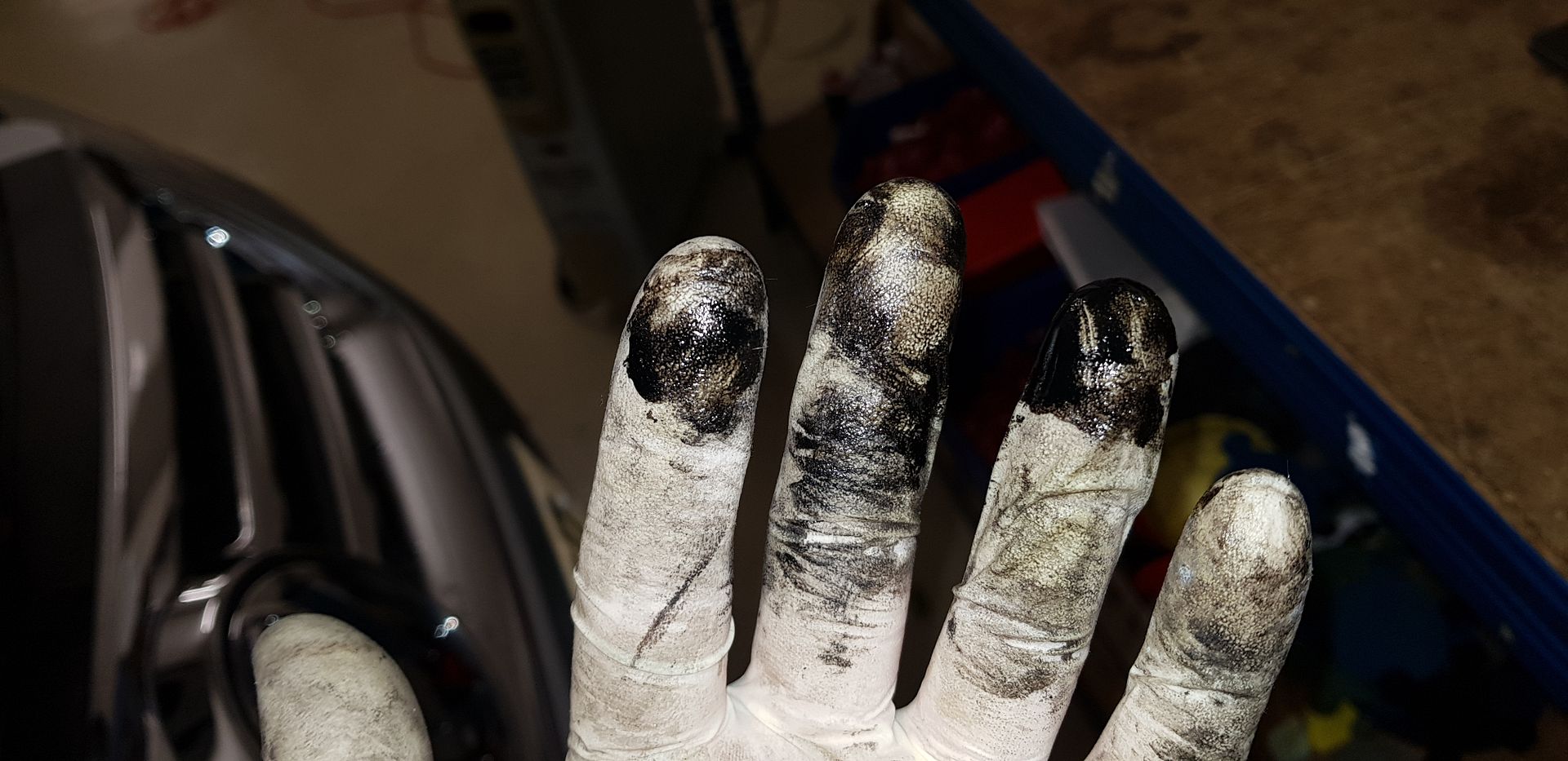

Just reaching down to find it resulted in a load of oil all over my fingers... so my suspicions of this being the cause of the oil leak were confirmed.

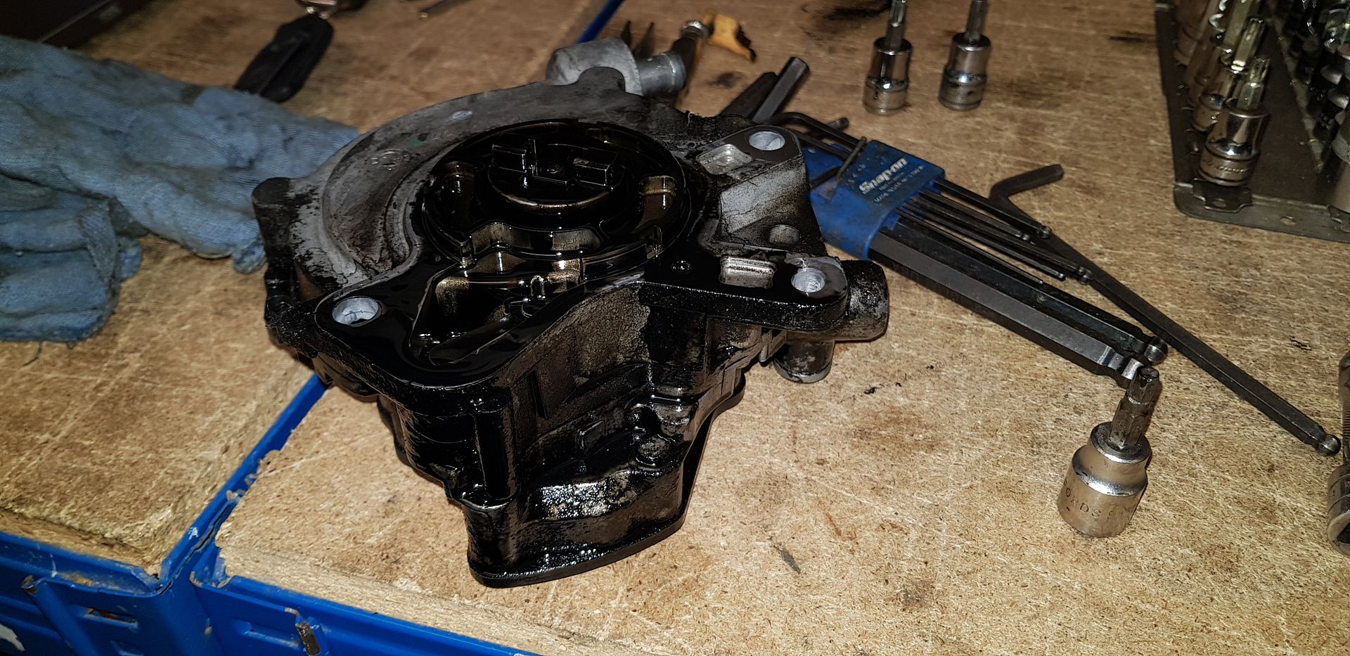

Once out... it'll look a bit like this...
Oilly mess that it is!

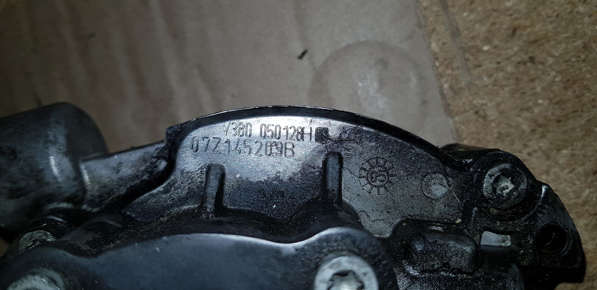

On this V10, it's the original pump to the engine as suggested by the date stamp of 2005 and the part number ending in 'B'.
