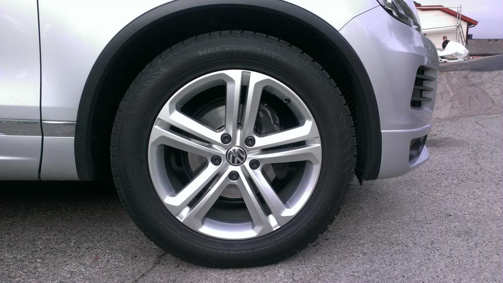

I have just put on my Winter tyres in Dimension 275/50*20 (Nokian Hakkapeliitta R on OEM 20" Pikes peak alloys). They do fit and fills out the arches well, but when turning the front wheels all the way to either side they will slightly rub the front plastic cover inside the wheel arches (just behind the front bumper).

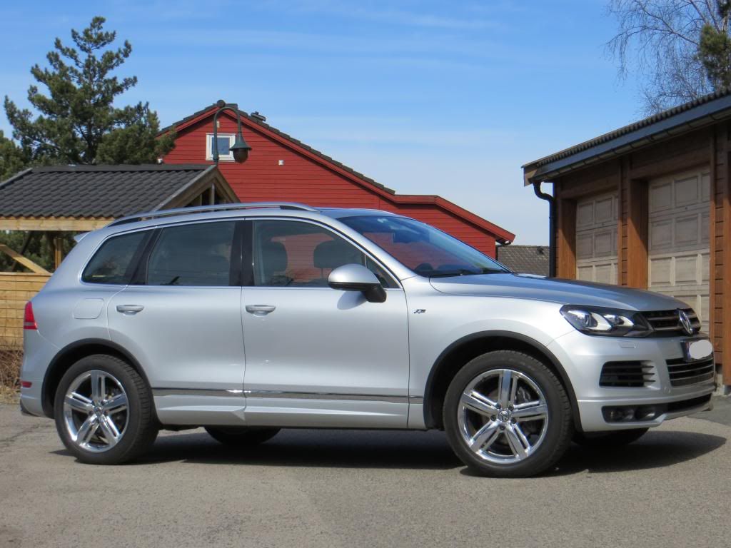

It will not destroy anything but shows that this is the limit. I have 275/45*20 as summer wheels and that is absolutely fine. A wider tyre with 50 profile (285/50*20) would probabely cause problems, but 285/45*20 (smaller profile) might work ok. 285/40*20 should be on the safe side.
This is how my 275/50*20 Winter Wheels look like:
And with the 275/45*20 summer wheels:
