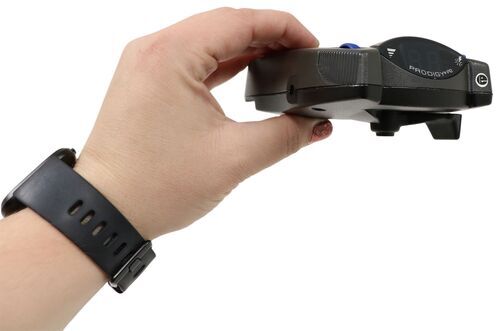

Installed the Prodigy P2 brake controller today. Came with a wiring harness. I ordered it from Amazon with a Toyota harness...
I wanted it with the Toyota connector as I plan on picking up a Land Cruiser 200 sometime in the near future. I just cut about a quarter way up the harness from the Toyota end and used the rest of the harness that connects to the brake controller to make my complete harness for the VW. There was no option for a VW harness so I ordered the parts need to make the harness from my local VW dealer. Not too local since the one near me wanted double the price than the dealer 20 mins away wanted, so I grabbed the parts up from them. Here are the part needed...wiring connector housing VW Part # 1J0-972-782 (1 ea) & wire terminal # 000-979-228 (2 ea). I think parts ran me 37 bucks. I just followed an easy DIY wiring harness build guide off of e-trailer.com.
Very easy an simple install. MY 2011 TDi came with the tow package. There was already a harness sitting wrapped up in foam on the left side a control box next to the brake pedal arm. After making the Prodigy harness to mate up, it was all plug and play.
