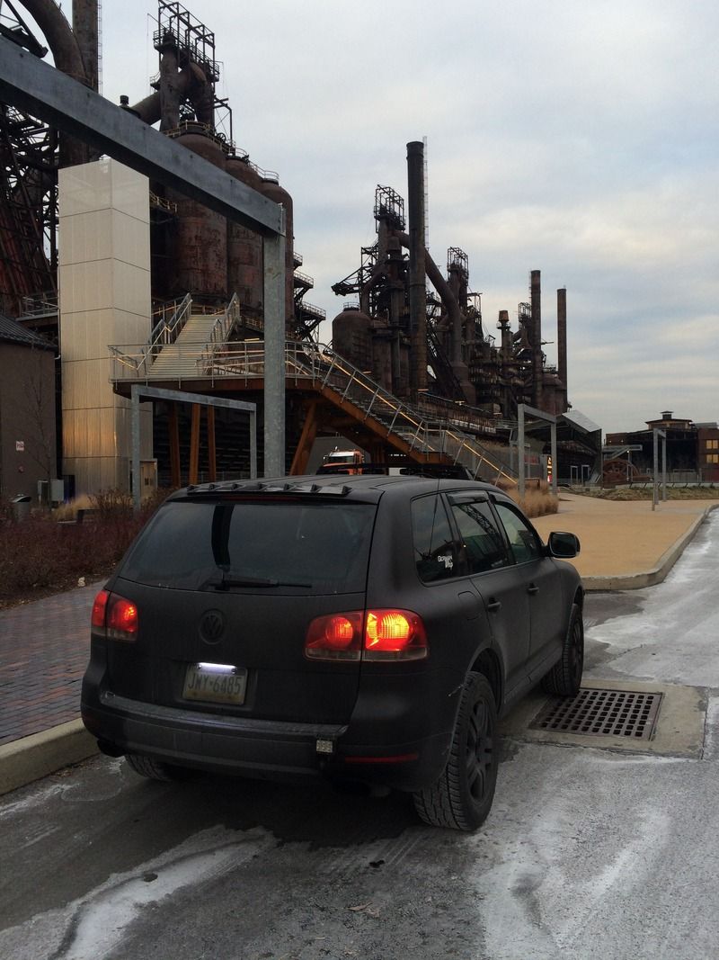

for $7 I got two white LED strips, wired it right to the license plate bulb holder, and the other strip is under the hood to that bulb holder. Exponentially more light. For cheap. Straight from amazon. No MFD bulb out display either.

Euro Skank how did you wire a single strip without error codes?
I fully expected to need to wire resistors inline. But it just didn't throw a code for either the under hood or the license plate strip.

I left one light in place and when I found the bulb holder corroded on the other bulb I used this LED strip. So I actually have two light sources. No code.
