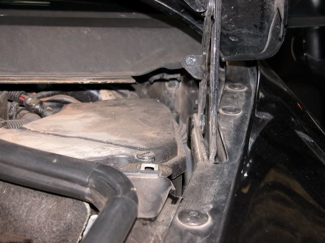

There could be some differences in the firewall design between my 2008 version and your 2014.
Here is the upper corner (passenger side) that I am referring to
Here you can see where the antenna etc are traced thru
here is where the trace comes thru into the LHS fuse box.
and a close up of the finished 'trace/pull thru'
Does that help?

Thanks mate. I think there is significant differences (at least cosmetically) under the bonnet. I'm sure that mine will have the grommet, but not as readily accessible. Another difference is that I do not have the air vents blowing into the door in my model... Will go back and take yet another look. I'd love to get to it without taking the plenum cover off, but that simply may not be possible...
If I get through (read "find") the grommet, I will post some photos of how, installation etc.

The rubber grommet covers the unused hole for the engine hood (bonnet) release cable. There are 2 symmetrical holes in the firewall, which one is used for the release cable depending whether it’s a left- or right-hand drive, the other one is plugged by said grommet. From the engine compartment, look where your release cable comes through, and then find the grommet in the same spot on the opposite side.

I have a draw wired run through now utilising the grommet as described. The Plenum cover indeed had to come off to facilitate access to the little blighter.
Now to feed the RF cable into the cabin...
