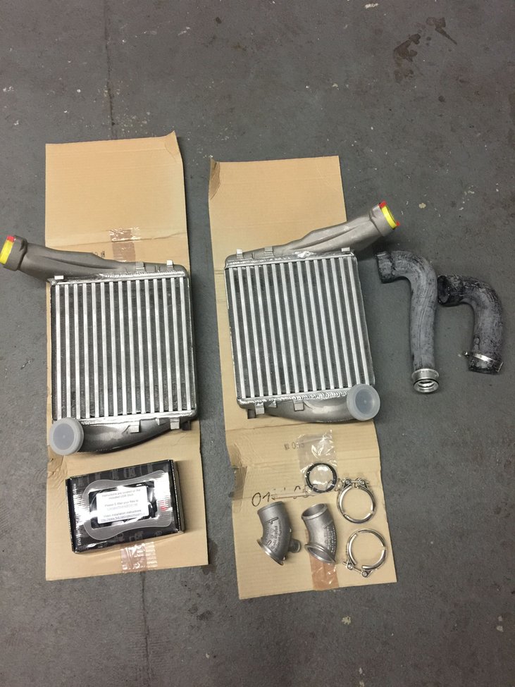

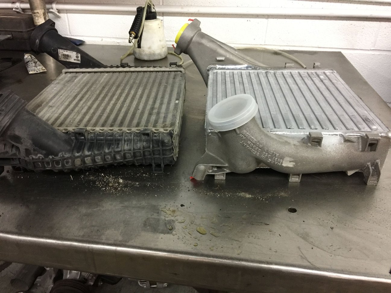

So in my quest for better than factory intercoolers for our 2014 TDi Exec. I came across the Porsche Cayenne intercoolers which are ALL aluminum versus just an aluminum core with leaky plastic end tanks in our Touaregs. The Cayenne end tanks are welded directly onto the core so they won't leak, and as an extra bonus the core itself is 2-1/2 inches thick instead of the stock Touareg 2".:grin2:
I know that these will work on the T3's, and I think that they can also work on T1's and T2's even the V10's as the part numbers seem to be the same across the Touaregs from my research, but please double check me before ordering for a T1 or T2.:nerd:

Found two offerings, one for each side. However looking the OE units and the cayenne units, looks like you would have to pick up the cayenne charge pipes at least for one connection per intercooler. The OE use clips for the connection, the cayenne use a press and screw in type connection.
