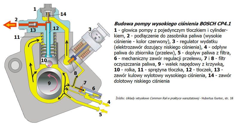

That video shows it going into the HPFP, through that metering valve and then compressed to high pressure or returned.. I dunno exactly where these are failing but there's alot more going on post meter valve than before it.. later in the video it shows the cam shaft is lubed by the feed back into the return (~1:40), so that would bypass the filter if that whole cam were to self destruct.. how much if anything is left of the cam after? Just the lobe missing, mebe.. if shaft is broken, doubtful.. you got the lifter pump still trying to push fuel through that dead thing.
Yellow is low pressure, red is high pressure, and green is return..

So the part that produces metal flakes is the 'cam' on the main crankshaft, which is before both the metering valve and the high pressure pump. If I'm understanding correctly, the flow path is: crankcase -> metering valve -> high pressure piston/cylinder -> fuel rail. Therefore, if the crankcase and followers fail and produce metal flakes, the metering valve can filter this out before it flows into the high pressure section of the pump.
This image shows the fuel path, where part 3 is the metering valve:
This website also has some photos and diagrams of the flow path, and failures, plus another even better idea for preventing the failure. Basically, they return all fuel from the fuel lubricated crankcase back to the fuel tank, so only freshly filtered fuel enters the actual high pressure parts of the pump:

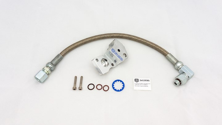

ok so I revisited this plan, and here's what I determined would be required to put the CP4.2 Bypass Kit on our vehicles, would require modification..
first a couple things:
  • Our HPFP's use hose barbs, the bypass kits are designed for hard pipes..
  • Since we dont have hard pipes our HPFP is not tapped for a bracket screw between the ports.
  • I'm pretty sure EGR is in the way, the return pipe is going to be moved about an inch forward to the motor and it seems to be in the way.
but, I think these could be overcome if your determined.. EGR removal would require blanking plates for turbo and intake, plus might require cutting off the aluminum coolant intake port on EGR and welding a hose fitting onto the end, looks doable, or trying to fit a pressurized hose onto the flange that bridges where egr used to be.. and of course a tune that removes it..
then you would have to modify the bypass kit bracket to cut the mounting off for the hard pipe its designed for and make enough clearance for the return nipple.
The aluminum high pressure line under the return line is about the same path the fuel feed line will take with the bypass plate.. just more to the right.
EGR in the way, look at fuel lines from above.. Maybe you can get lucky and retain that, but it would be a very tight fit..

I emailed S&S asking if they could make a universal CP4.2 bypass plate that allowed for hose barb fittings for both input/output.. they responded thanks for the suggestion the'll pass it on to development to see if its possible..
I linked em to this thread, if they made one and it fit w/out modification.. we'd all be buying em like hotcakes right? I know I'd be willing to drill and tap the missing mounting hole if thats all it needed and had hose barbs in same general location as OEM so nothing major had to be removed to make room.
I'm likely going to get one (or a cp3...) but am not messing with the pump until the warranty is gone.
yeah the more people that come off warranty the more demand for a universal bypass plate would be, looking at the CP4.1 pump in the 4cyl CR Diesels from VW/BMW/Merc its physically identical at the metering valve and hose barbs, it would also fit on those vehicles too.. and globally thats a buttload of HPFP's out there that would like some protection.
Here's a guy trying to create his own for the CP4.1 because the powerstroke specific plates wont work for him, unfortunately he uses a separate feed line that makes it incompatible w/a CP4.2: 328d HPFP Bosch CP4.1 "Disaster prevention plate"
Even at $300, thats a fraction of the cost of doing a CP3 retrofit, assuming your lucky enough that is an option.
