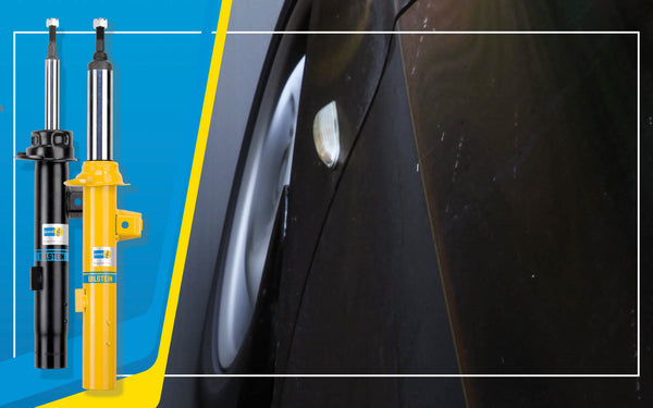

Does anybody know the difference between the Bilstein b4, b4 sport and the b6 sport?

Somebody pointed this thread out in a different thread, so I'm going to update it.
I personally looked through the Bilstein catalog and did NOT see a Bilstein b4 Sport available for our Touareg
So I then called ECS and got into an in-depth conversation w/ them. They must have access to different parts or something because they pulled them all up and gave me this description
Bilstein b4 - supposed to be a bone-stock replacement shocks. I'm not saying it won't be a slight upgrade, its very possible Bilstein has revamped rates/etc on these since they've first come out
Bilstein b4 Sport - they do exist, and are made to be a slightly sporty upgrade to handling.
Bilstein b6 - they are a major upgrade to handling, but also ride stiffness. Some theorize that the b6 may raise ride-height just a touch. If you review other German cars w/ the b6 upgrade, they do. But with the Touareg weighing 5k lbs I speculate you will not get any additional lift unless your current shocks are blown out, this will restore them up to factory ride height
Bilstein b12 - a very sporty suspension kit that induces a drop
Bilstein does NOT release "% over" numbers. So for instance, they will not tell you how much sportier or % stiffer a b6 is over a b4, they will not tell you a b4 Sport over b4 etc.
