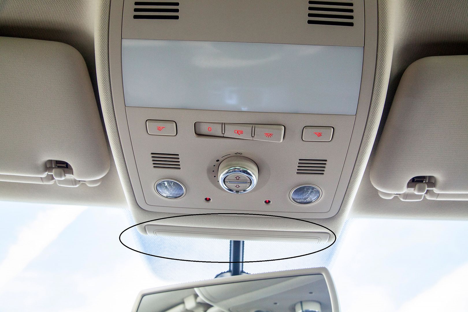

Hey! I'm trying to track down this plastic piece. I've circled it in the image. I'm trying to modify it for some emergency lights (firefighter) and wanted to have a backup piece on hand in case some goes wrong lol. Thanks!

FYI - That's where your Homelink sender is located - there isn't a lot of room behind it and if you put something up there it may well block the signal completely.
Also, with the little black dot sunshade up there, if you put lights up there they will a) be really diminished and b) reflect back into the vehicle like crazy off the little black dots.
Just my .02. As for the part itself (to answer your original question...), I'm not sure.

I believe it's called an Insert Panel, Part # 7P6947134H67, Can be found at VWpartsnation under Body/ Overhead console
Perfect! Thanks a ton for the part #. That helps tons!
