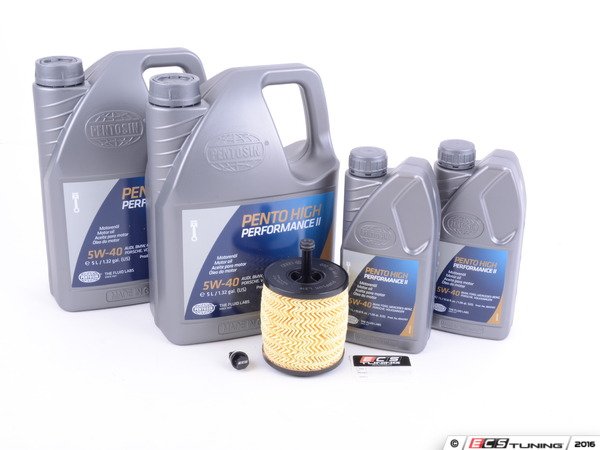

Either 5W-30 or 5W-40 can be used, depending on your climate (where I live heavier 40 weight oil is better). What I have learned from talking to old VW techs and various forums, for our US spec '06 5W-40 synthetic 505.01 is recommended to best lubricate the cams in the PD injection system. 506.01 was speced for the early DPF's by VW, but since my DPF's are gutted (as are the OP's) the near-impossible to obtain 506.01 spec oil is not required for ash reasons so 505.01 is just fine, which that oil meets.

It's not that it's "not required". It's the wrong oil for your engine. As is any 505 oil, especially if it has 5W-40 viscosity, like the one recommended above.
