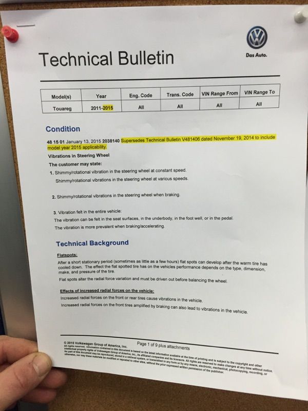

I have a relative that is a VW tech and he just called and let me know that a TB was published yesterday for all Touaregs 2011-2015 for Steering Wheel Shake.
TB 48 15 01 was issued on 01/13/15

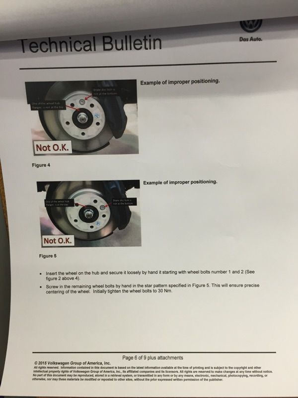

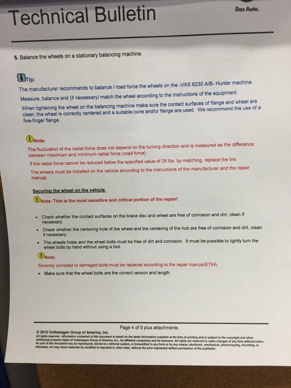

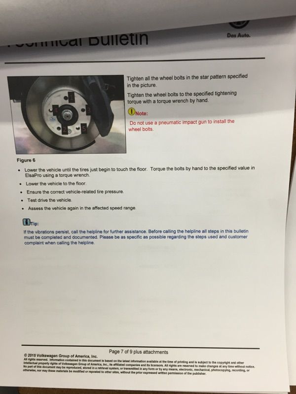

It speaks to the problem and states 36PSI , torqueing nuts by hand and in a specific order.

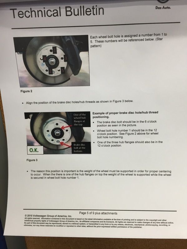

It also speaks to that the brake disc bolt hub needs to be in the 6 o'clock position.
This should take 90 minutes to complete.
Hopefully this should resolve the issue.
I pick my 14 Lux up this afternoon and will insist this TB is completed before I arrive.
JEC

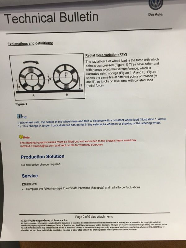

It's a 9 page document that was sent to me via cell phone pics. a large portion of it was illustrations of how to star pattern tighten the lugs.
I wanted to share the highlights and the TB #. For those currently dealing with the problem.
I will say that my dealer is already giving me a hard time about performing this prior to my arrival.
Right now it's 50/50 if I'll be driving a Touareg this afternoon.

Just called VWoA and unfortunately TB 48-15-01 does not exist, the latest TB they have is 48-14-XX. I also would like to see the actual print out if possible.
It exisits my dealer showed it to me. I took delivery today but didn't need it since after a 45min test drive it doesn't shake.
The TB, is dated 1-13-15.
I can't explain why the person you spoke to at VWoA don't know of if but believe me it exisits.
You might want to call your dealer directly.
1,829 Posts
Just called two local dealers and none of them could find anything related to the TSB you've posted. If you don't have time I'd be happy to call your dealer to get a copy of that TSB. All you have to do is to post their number :)

This procedure for tightening was posted by another member last summer and followed by me after we got our 2011 Lux with 19" wheels and our car has been good ever since.
Makes sense, my auto shop teacher in high school (1979) taught us to put wheels on in a similar manner and always tighten in a Star pattern, finger tight first, light pressure with a ratchet and then come back with proper torgue with a torque wrench to finish.
My kids know to do it this way also, it's not Rocket Science.
Thanks JEC PA
These cars have a different style hub and lug bolts than I have ever seen on any other vehicle, by orientating the wheel with the brake disc bolt at 6 o'clock position puts one of the 3 centering flanges on the hub at 12 o'clock position to properly support the heavy wheel and using star pattern further promotes getting wheel centered.
The 19" and 20" wheels are very heavy, if they are off center on the hub by the smallest amount all that mass can cause problems staying centered no matter how whell the tire are balanced.
