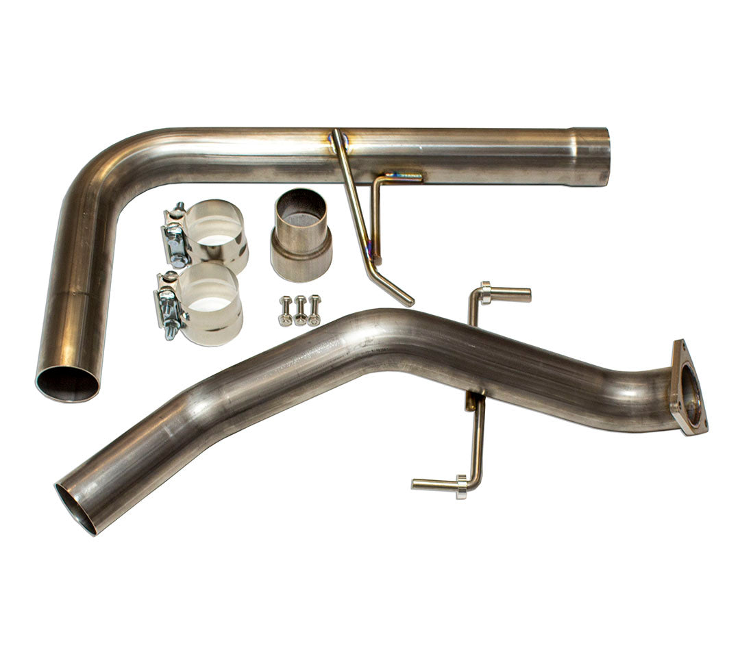

Buzzken delete kit is on sale
it annoys me that it is made in Canada, shipped to USA, then shipped back to Canada. I will most likely pay duties/ bein rape by UPS...
I didn't pull the trigger yet, but it is sitting in my cart; looking at me.
3,312 Posts
Junk.... uses cheap 409 SS... read Stainless that will rust from all the salt we drive through.
Also very pricey in my opinion.... there's nothing to it... any fab shop and muffler shop with a mandrel bender should be able to make you that..... but everyone needs to make money, so I can see the other side as well.
Reactions: zambony
472 Posts
Discussion Starter · #115 · (Edited)
The rawtek equivalent is even more expensive. but made from 304 SS and 3in VS 2.5 OD.
Expected life is 8-10 years as per summitracing, aprearance is definately not as good after a short while.
arghhh I don't want to do this twice. I definitely don't intend to keep the car more than10 years (nothing wrong with it, just not my style to keep them so long), but there is more reading to do.
moderate climate - just looks at heat cycles........ doesn't take into consideration salt "bath" on top of it.
I don't know if they spray that nasty brine crap on the roads where you are, but down here, they do.... it's more or less acid and just eats our vehicles... you can see 5 year old vehicles rotting away if they are DDs and don't live in a garage.
472 Posts
Discussion Starter · #117 ·
I get you, and I am not going for it. I think. There is absolutely no rush to do it as my DPF is fine for now.

I consulted my brother-in-law regarding 409 stainless steel. I don't know nearly enough about metallurgy to make an educated comment but my brother-in-law runs a pretty huge foundry that does work all across the globe and the following is his response on 409 stainless steel:
So 409 st/stl is strong. It is not used for visual appeal. It is used a lot for car exhaust and other applications that require gas corrosion resistance. However it will rust and tarnish. Not a pretty st/stl but a workhorse in the right environment.
Also:
If would recommend 304 or 316 stainless. Much better corrosion resistance but also usually a higher pricetag. 409 will work but won't hold up to winter salt and snow well.
Also:
It will eventually rot out but not fast like regular steel. It usually starts as surface rust on the outside especially around welds then rots in until it has some holes. Like I said go with 304 or 316 if you can but 409 is definitely a lot better than a standard steel exhaust.

First, material is not optimal; but better than aluminized steel normally used in car industry for exhaust; which typically last 10ish years. I don’t think I’ll keep the car that long. Nothing wrong with it, love it; but I don’t think I ever had a car that long in my life. 5-8 years maybe. The only thing that could justify to sell it at this point would be tremendous maintenance cost; as I really enjoy the vehicle & look. Not ideal, doesn’t seems like a deal breaker.
Second, with power dream/goal; 2.5in seems quite tight for a 3.0 engine. I mean, I was running a 2.5in on a 1.8 Vtec engine and it was fine. I understand that bigger is not better because of the velocity loss, and turbocharged engine get backpressure from the exhaust manifold/turbo and what comes after that is not a big game changer. 3in seems right…
I am not concern about fitment for the Buzzken.
The rawteck posted above is almost the same price (620 USD VS 560USD). 304 SS and 3in. I guess I’ll wait.
Interestingly, rawteck downpipe is cheaper than buzzken.
