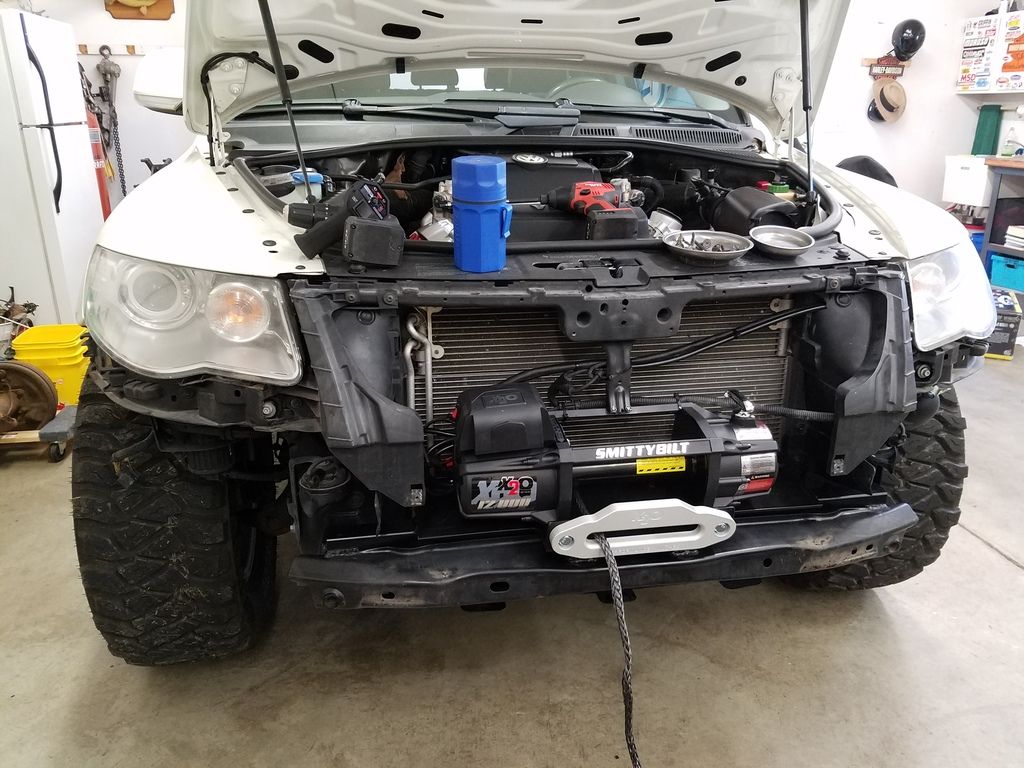

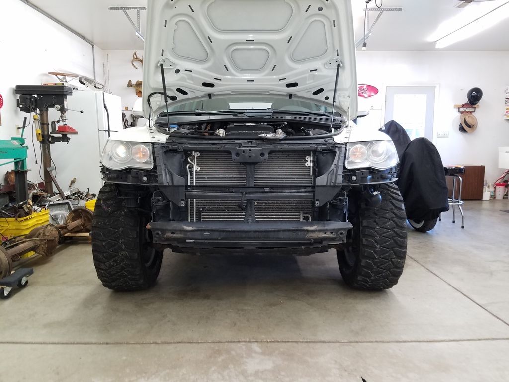

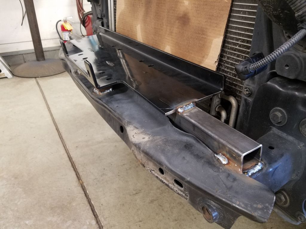

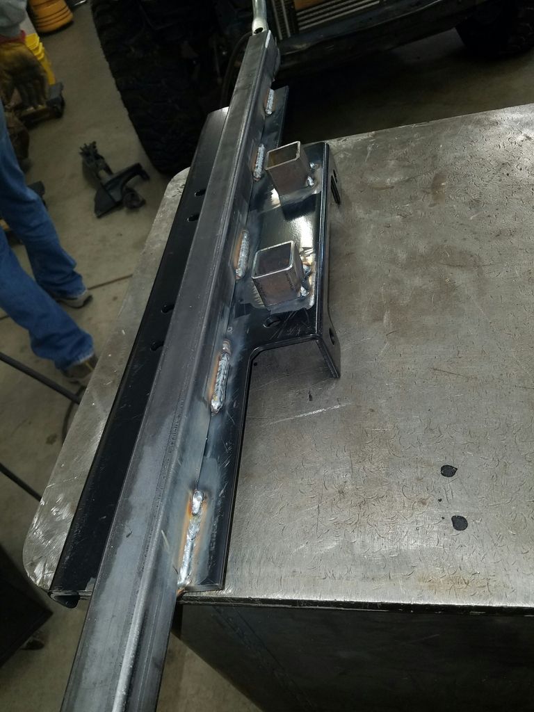

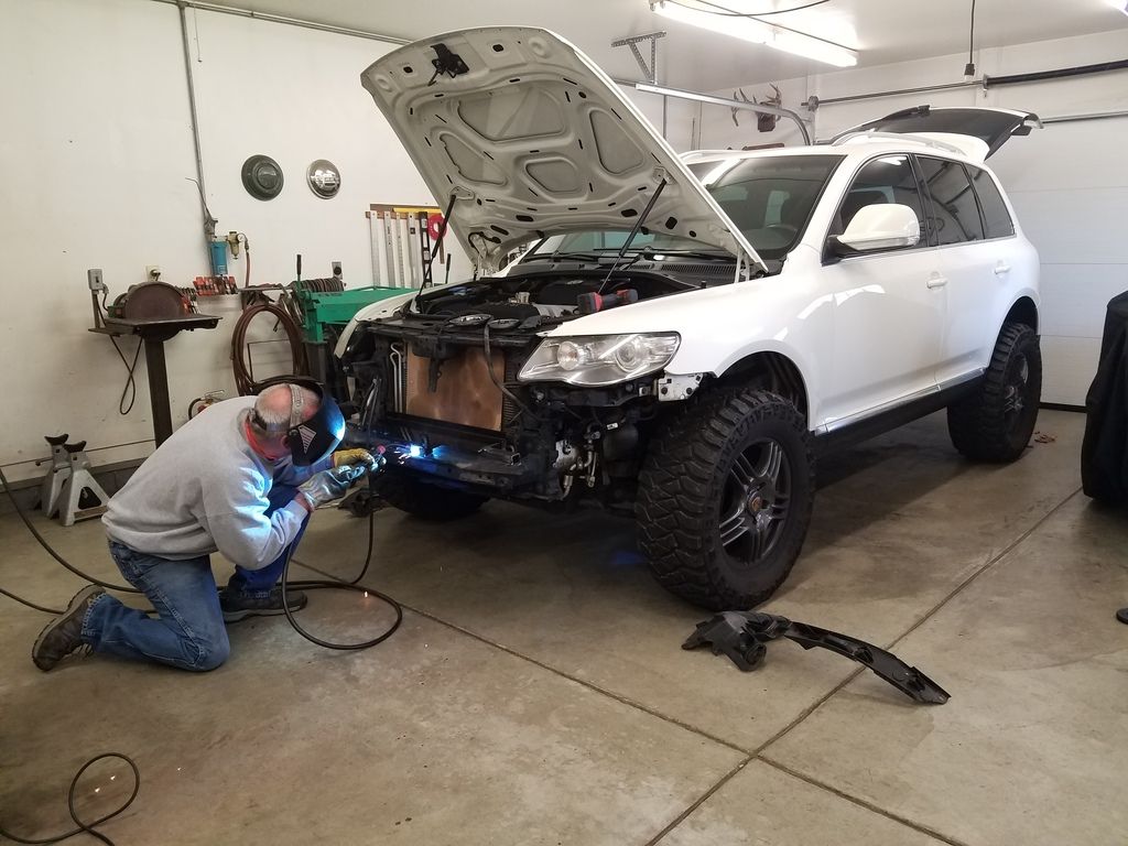

So... Did another winch install.... These pictures are probably going to look very familiar to some of you but I assure you they are all new photos of the new install, haha.

Looks nice, good work.
146 Posts
Wow I cant believe how slick the winch looks!! Servicing may be a bitch, but after how many time you have taken that bumper off doesn't seem like an issue

The winch is amazing!!!
