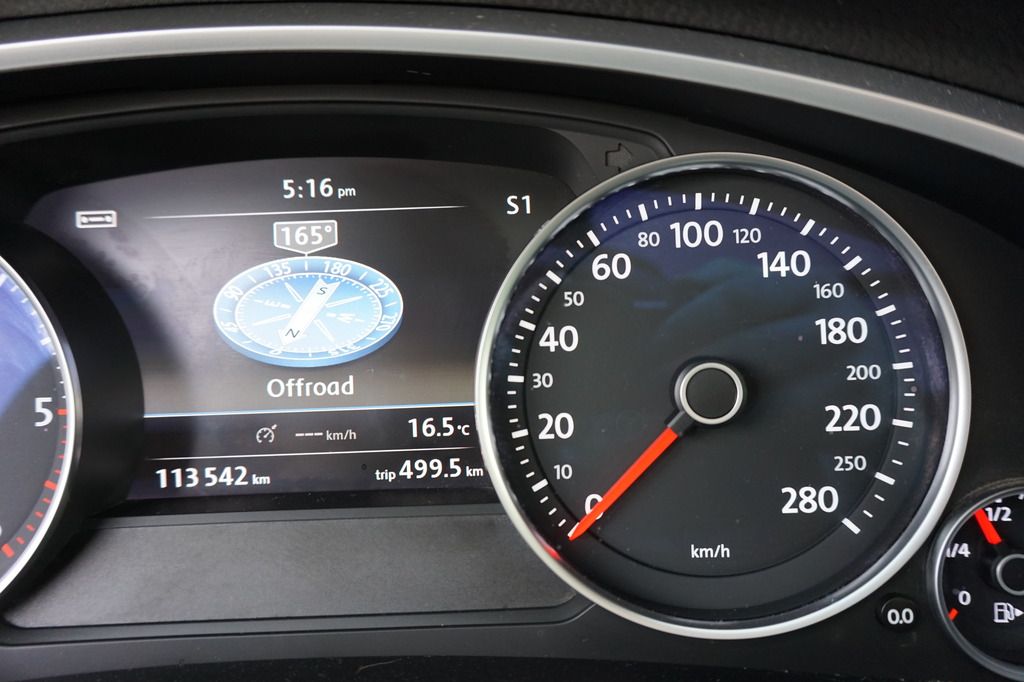

Here we go on my 3.0 tdi build...coming from a 2.0tdi with 240hp this thing needs some love :).....so long term is 300+ hp with a gtb 2260 hybrid turbo....heres the start
my buzzken exhaust and we were setting up a baseline for my tune...should have the tune and exhaust in this weekend.
dpf delete
def delete
all cat deletes
downpipe
stage 2 jr tuning tune
anyone is curious there is 13 or more faults with everything unplugged that needs to be deleted. Im keen to see how it turns out.....oh and we figured out gear indication for the n/a t3s

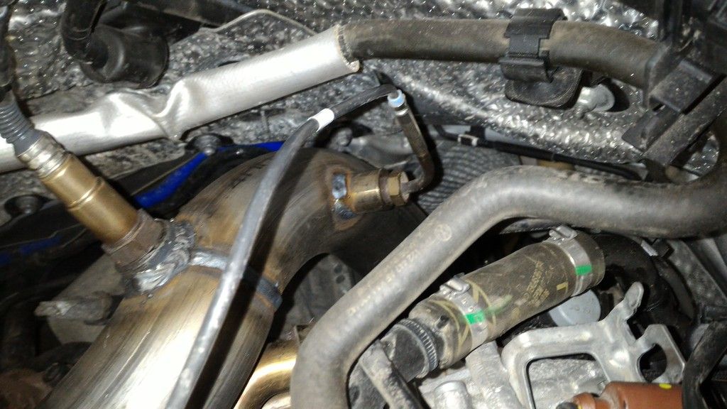

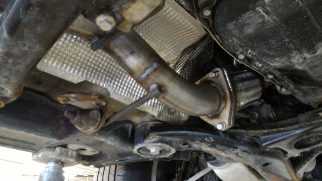

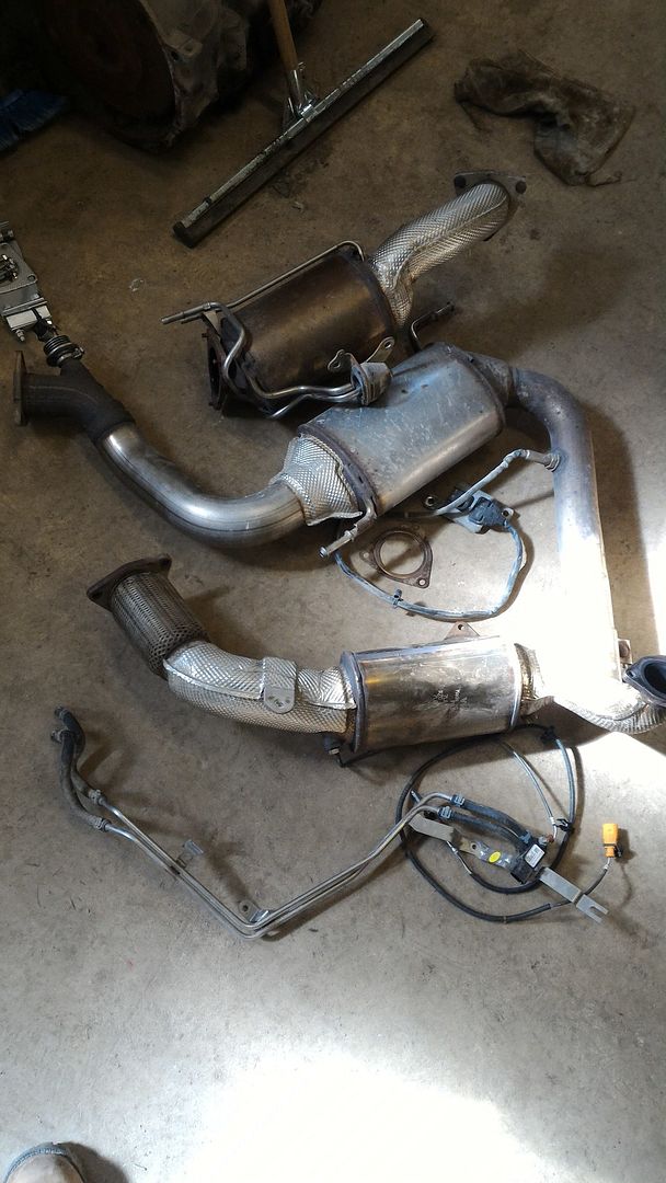

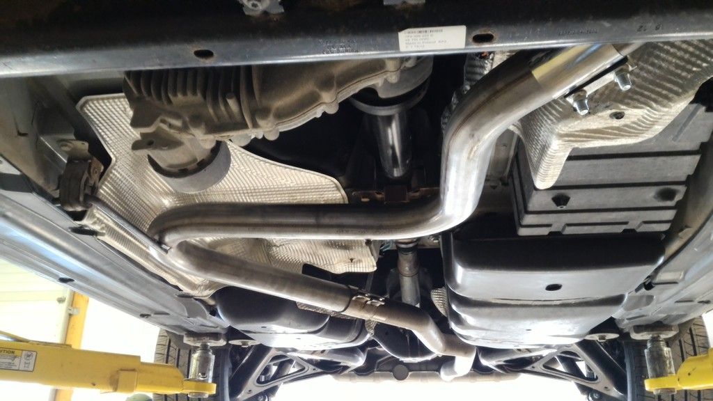

exhaust is in.....downpipe was a pain and the 6 bolts clamping the exhaust flanges the nuts were rotted. just as an fyi...the rest was pretty simple.
dpf, scr adblue, differential pressure tubes, down pipe and sensors out
Downpipe in
Dpf delete pipe to downpipe connection
Thats better
