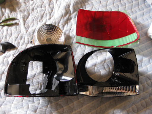

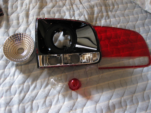

Try putting a little force, otherwise the lens moves, and use the cutter again.

Manage to get one light ,but cracked a piece of the other. I wonder if a dremel tool will work better in removing the lens. The problem occurs when you start poping the lens after you scar the plastic. I did it a few times going around the lens at least 4 times.
Del
