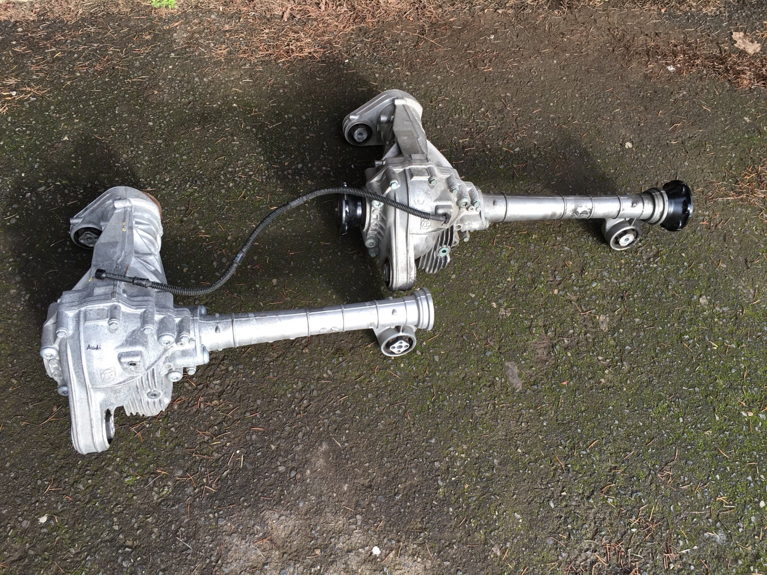

I picked up my Q7 diff today and it looks great... $375, got it within one day of ordering, 63k on the part, it's the right part number, exactly what I was expecting (except it didn't come with axels, good thing these are interchangeable with the Touareg ones).
It's crazy though that VW charges $4k for this thing new. It literally weighs about 40lb... I didn't even have to fold the seats down in my A4.

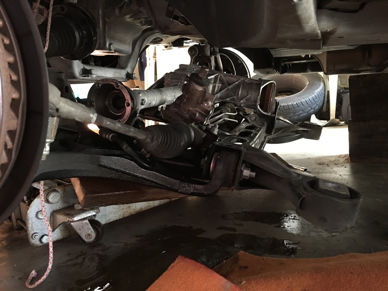

Ladies and gentlemen, today was a true test determination and upper body strength... And it was totally worth it. The Touareg is back on the road with the 0aa409508q and it's quiet and smooth... So chalk up another 0aa409507h failure. As far as I can tell, the carrier bearings are shot, I'll have to do an autopsy at a later date to tell for sure.

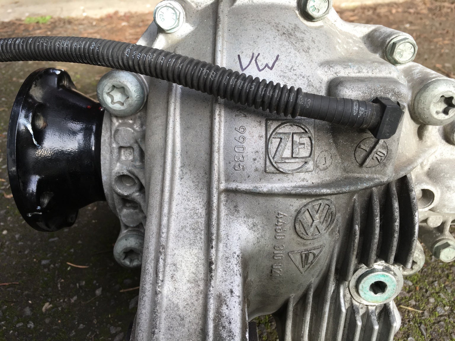

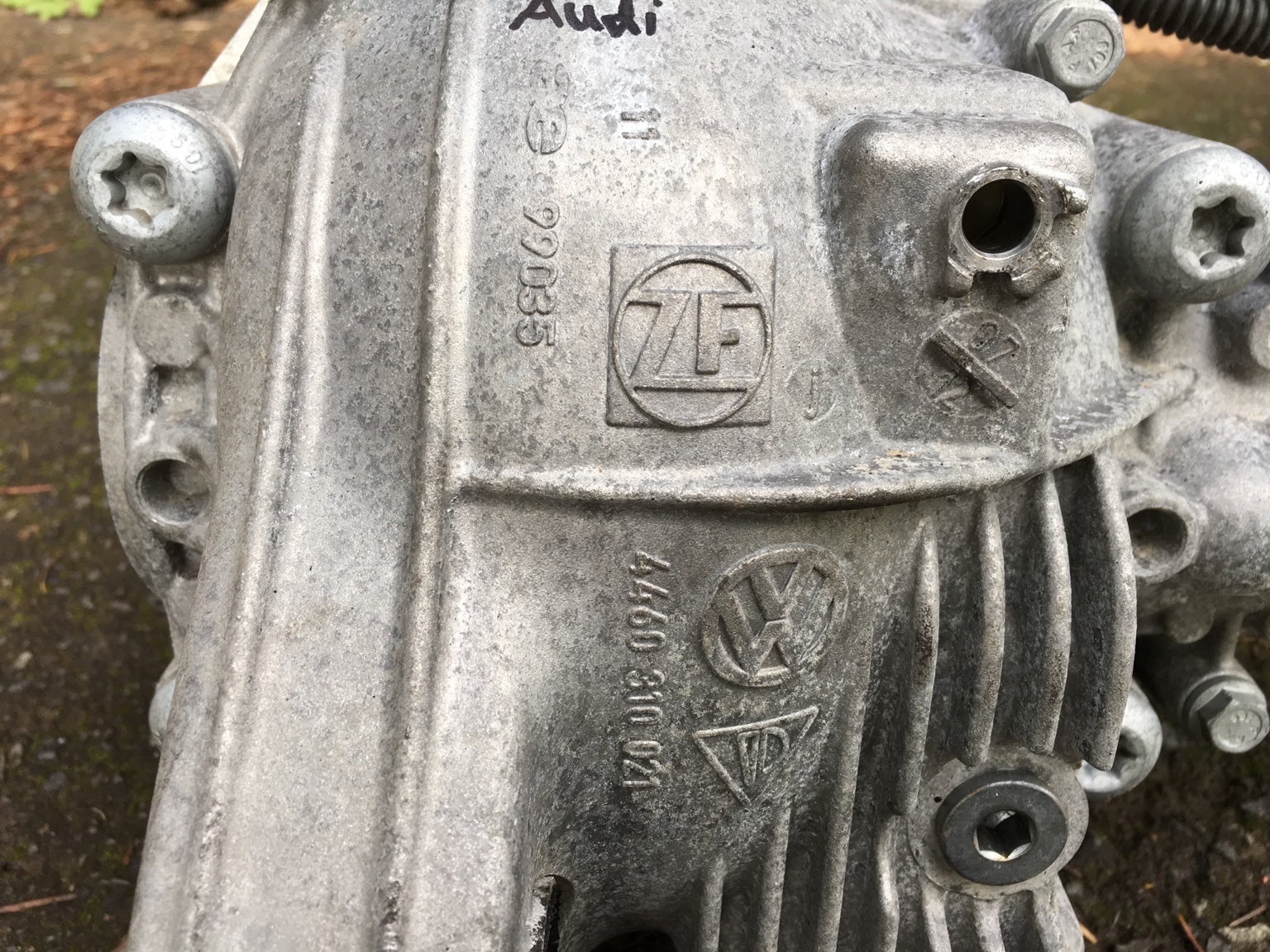

As far as I can tell, the two differentials are identical... The bushings are indeed slightly different, but their fitment is identical. Internals may be different somehow, but the gear ratio is indeed identical. If I have any problems with it I'll post but otherwise, I'd suggest going the q7 diff route. I got mine from an local auto recycler for $375, but there are some on eBay for $320 with free shipping.
