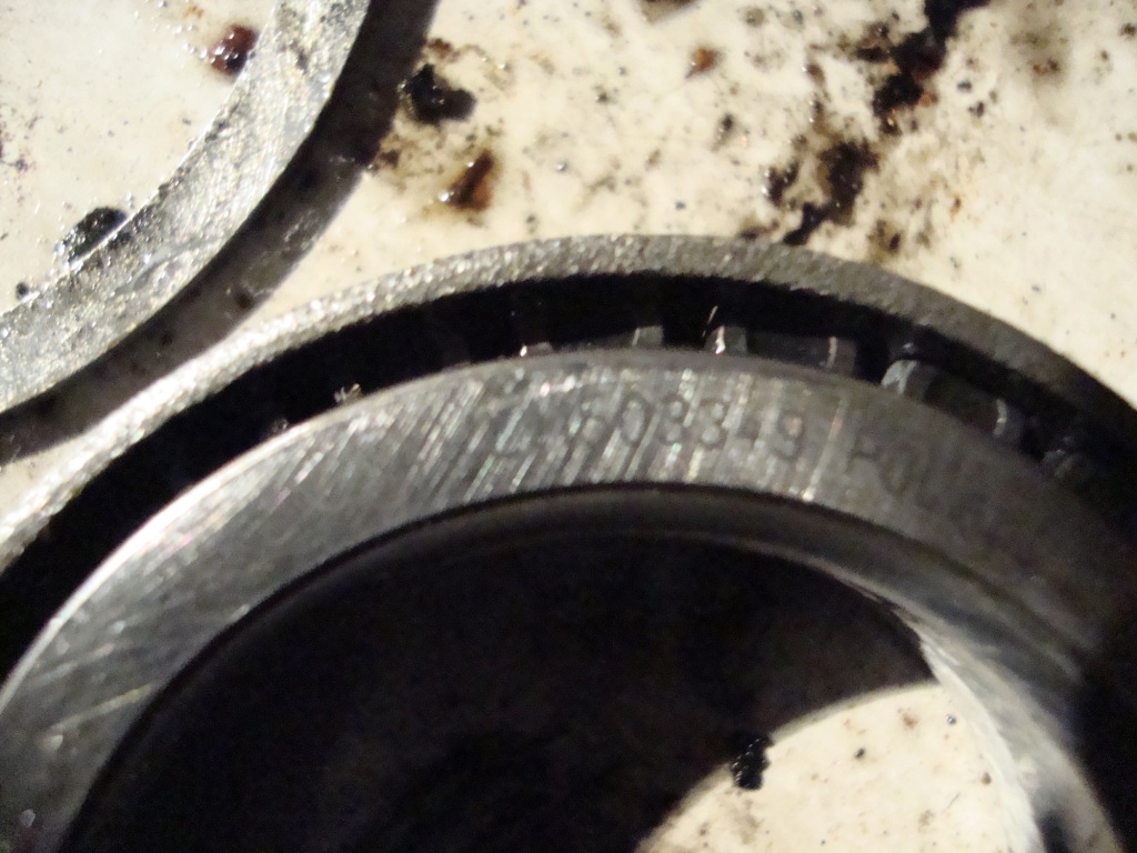

208 Posts
I quickly made some pics, bad resolution, it was already dark (don't watch the messy table ;-) )
On the first pic, you see all components inside the diff.
The diff carrier is held in place by the Timken bearings, supported by 2 shims.
The thickness of the shims determines the tension on the bearings and the clearance of the pinion gear and crown gear. But if the gears are in good shape, you can reuse them.
I work in a tractor garage and almost all diff clearances are between 0.15mm and 0.3mm, measured on the crown gear.
On the 2nd pic, the original Timken bearing 503349.
I hope you find all parts because it's not easy as they are not OEM Volkswagen.
I looked for a lsd diff lock but i can't find it...
3rd: A try to show the bearing housing.
The diff is not that difficult but the clearance and tension on the conical couple is very important.
If your bearings have to much tension, they will wear to early and cause friction (consumption) -> to less tension, diff can wobble around, gears and bearing will wear.
If the clearance is not good, you will have a whining noise.
Sorry for my bad dutch <-> English technical terms, if you don't understand it, let me know ;-)

Update: I believe the Ford based 8.8" (Not 9", there is a difference on pinions and ring gear diameter) ring gear and pinion sets will be what's compatible with our differentials. The Ring Gear is a 10 hole design, spans all of the final drive ratios of our Touaregs, Q7s and Cayennes from 2004-2014, initially appears to be dimensionally equivalent (will confirm shortly) and should work with our existing differential carrier. If the Ford based 8.8" sets are the ones that will work, then I will have the spider gears, pinion bearing, crush ring and shims sorted out and we can start completely rebuilding our differentials!
The Timiken carrier bearing is part number LM503349
The Timiken carrier bearing race is part number LM503310
Both are common on many differential carriers 8-9"
I feel the two Timiken bearings and races above were replaced alone, it would solve most of our issues if caught early. I'm going for worst case scenario rebuild info.
