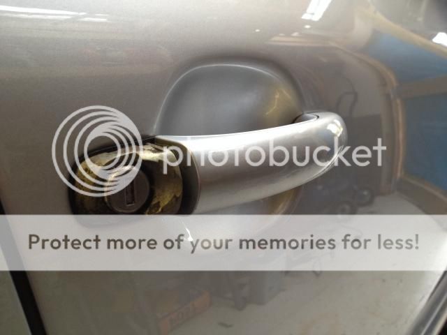

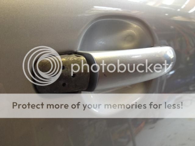

Im in the middle of wrapping my 2005 touareg, and want to take the door handles out to get a better finish, but i can only find guides for kessy system handles.
I've taken off the covers but i am now faced with this....
If someone could shine some light on this for me it would be greatly appreciated

Open the door, look at the inside edge where the handle is. There are a few plastic caps. pop them off and you can access some bolts. It requires a triple square I believe to get in there and loosen it. I can't remember what one loosens what however, I hope someone else can chime in. I had to remove the interior door panel and inner cage and window, but I think it was only because I was routing kessy wires. Don't just try picking bolts though, there is a do one first type approach so you don't lose the tension.
