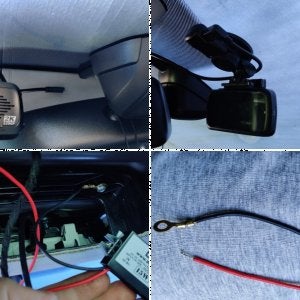

Hello guys,
I would like to share an idea with you. I got inspired by new Skoda Octavia which has integrated USB socket for dash cam, so I decided to "copy it" :LOL:. These long 12V cables are annoying, so here is nice solution.
Parts that u will need:
  1. 12V to 5V DC converter with USB output
  2. USB-C to MicroUSB 90° angle cable
  3. USB male to USB-C female
  4. 3A or 5A fuse
  5. external fuse box (I have used oem fuse box in car)
Instructions:
  1. detach cover behind mirror and make a hole for usb-c
  2. glue the cable (part 3) to cover
  3. find 12V source which turns off with ignition (for me it was lowest row in fuse box on driver side) - huge black cable
  4. put cable from fuse through A pillar, headliner to overhead light switch console
  5. + cable solder to + input on DC converter and - (ground) attach with existing screw to roof
  6. connect USB cable from converter and socket
  7. assemble everything back to place
Documentation:
If you miss something in instructions, feel free to contact me :) and sorry for "not great, not terrible" english :ROFLMAO:
