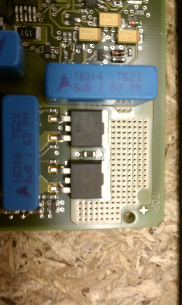

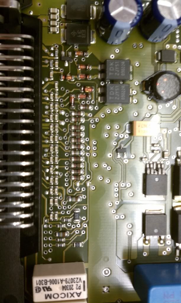

Took my old KESSY apart today and am trying to identify and test the components. In the first picture I believe these resistors to be the ones in question. In the second picture are the mosfets. So far I have continuity on the resistors, but haven't figured out how to test the mosfets with my multimeter. The issue with this KESSY is that the door handles wouldn't operate. Is it possible one of both of the mosfets could cause that? Resistors seem ok.
It's not a matter of IF something breaks on the Touareg. It's just a matter of WHEN!
116 Posts
I can't help much with testing the MOSFETs, not even sure if you can do that in the circuit. Just replace them, for the few bucks is a no brainer.
It worked for me.
I agree. Seeing how you're already in there just replace both transistors.
I had no continuity with one transistor which caused none of my door handles to function along with a parasitic battery drain.
